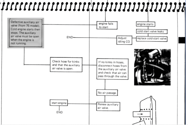

Jim found the same difficulty as you in trying to document changes.
Jims CIS Primer does not say there was an AAR in 1975, just a switch in production to a vacuum WUR eliminating the TPR.
http://forums.pelicanparts.com/uploa...1586708273.gif
Porsches K-Jetronic Troubleshooting Guide is the only mention of Aux Air devices in a 1975.
http://forums.pelicanparts.com/uploa...1586707813.gif
