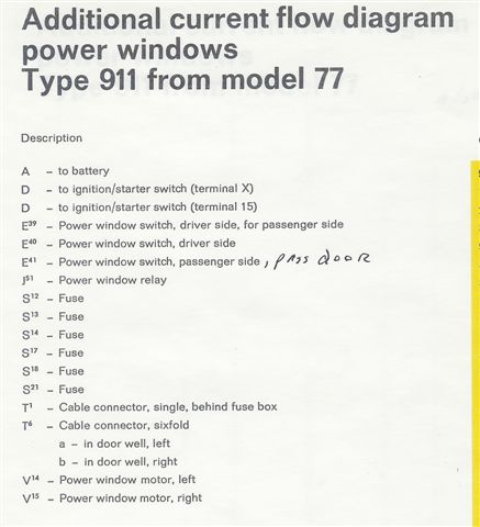

I don't want to steal this other users post, but he has a good schematic of the window motor circuit. Power Window Switch Schematic.
If you follow the lines, you can see the traces apply either forward bias (positive voltage) to the motor or reverse bias (negative voltage). The switch just changes the polarity. DC motors are neat because they can run forward or in reverse just by this simple change. They are really not much more complicated than that for a basic intro.
These cars were developed in a pretty basic age as far as car electronics go. I think the most complicated issue is knowing where all of the wires go and which circuits are tied to which. The actual functioning of the circuits is pretty straight forward.

Excellent post.
First reply that is actually on topic.
The battery wire goes through 2 fuses, #17 & #18
Why is one yellow and one red?
Wire then goes into the J relay.
Ignition switch closed, power flows through 85/86,
which then closes 30/87, allowing current to flow to window switch E39/E41.
Finally reaching the window motor at V15.

Can you explain how you read this? How does the diagram show the 2 different states a window switch can hold?
