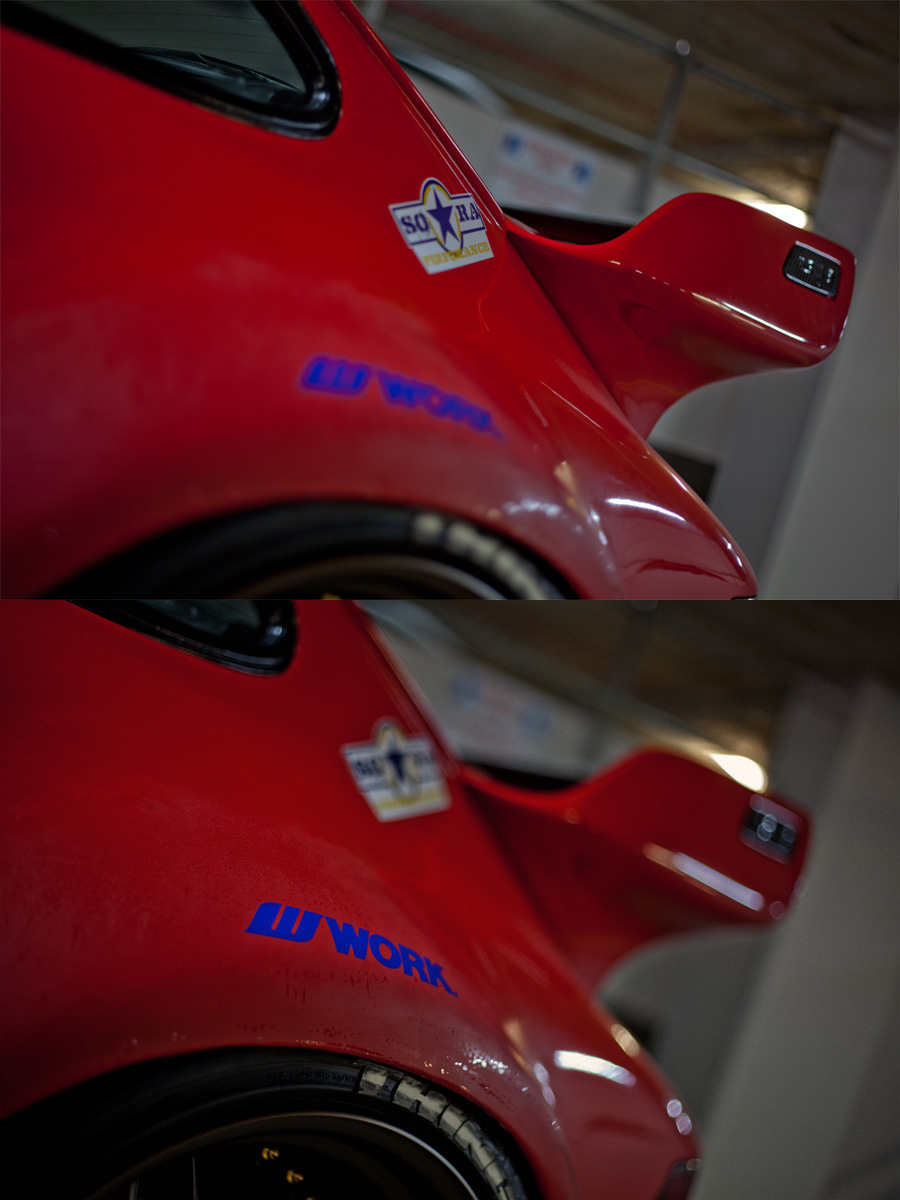

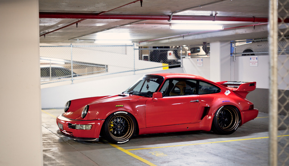

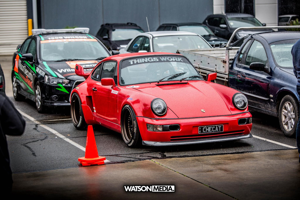

haha, 1982 SC with former slant nose conversion to 930s, so, I believe turbo fenders. Not sure if it`s bare stock suspension but I`d guess it is. Right now - turbo front fenders turbo rear ones
10x18 and 12x18 with -11 (negative 11) and -23 (negative 23) offsets
tyres are stretched and camber is negative (as much as it could be achieved with original suspension, so not crazy negative)
rear left fender rubs under acceleration and a bit closer to the tyre than the right side, my guessing is that it`s not perfectly matched side to side
and yep, she`s converted once again, by me this time
Awesome what size tires my car is a 82 sc converted by me. Wow you car rocks what wheels
Old 10-26-2020, 10:08 PM
Join Date: Sep 2014
Location: Melbourne, Australia
Posts: 191
Thanks Kevin, the tyres are 225\40 and 295\35 (yep, 295\30 is wrong)
