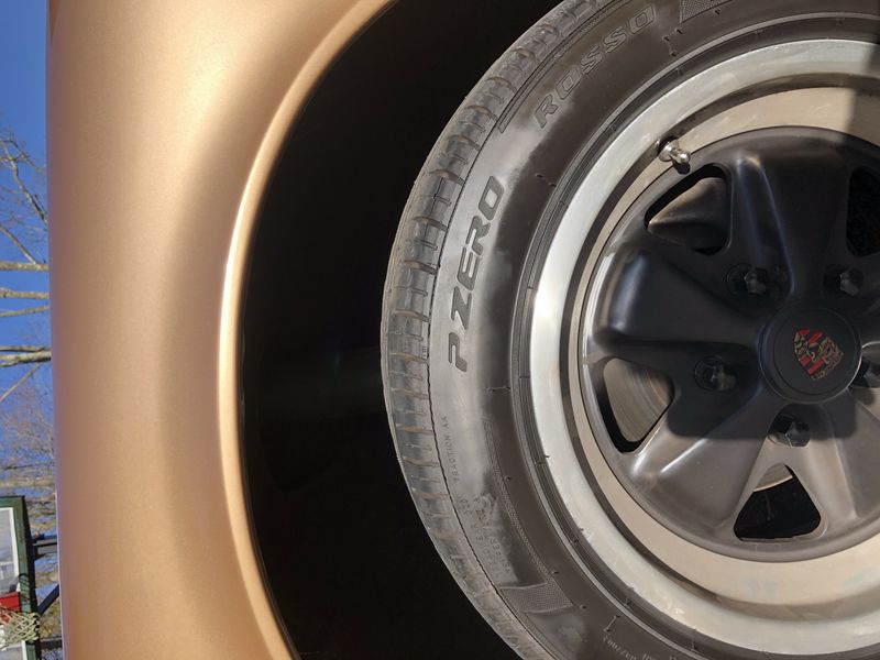

Ok, so I finally tackled this project (somewhat). I wasn't ready to have the fenders rolled, but I did want to address the bulge in the fender.
I didn't want to use a conventional fender roller, nor a baseball bat or rubber hammer.
So I bought this silicon roller from Home Depot, thinking it would do the trick. (My wife in the background - and no, I'm not trying to erase her).
I assembled my "tools" - heat gun, paint tape, roller. Jacked up the car enough to provide room to work without needing to remove the wheel.
I taped the area, applied some heat, and used elbow grease to work the area. Right or not, I liked the somewhat soft feel of the roller.
End result:
It hasn't solved my issue per se, but it only had become one due to the combination of full compression of the shock while doing a sharp turn.

At least you know where it hits. You don’t have to roll/trim the entire lip. As I recall, there’s another section that interferes; about 5 o’clock, but don’t quote me. Depends on tire brand and size.

You can see in the top pic where it cut the tire. Gonna happen again.
Yes it will, but I'll address it in the spring after it comes out of hibernation.
