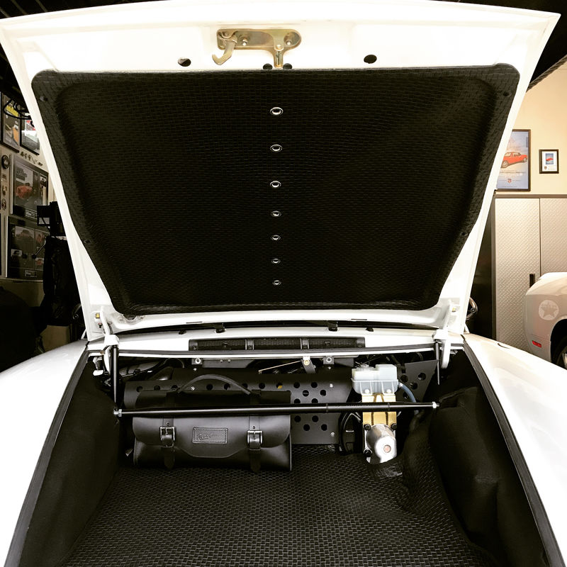

rothaus 01-03-2021 09:22 AM
I did a second set of these, and I can tell you none of these cars are exact the same. I cut out the plywood based on the Carrera. You really have to have the car there and fit all panels individual. I don't think that I would make them and sell, and then nothing fits. Like Tom said above, it's trial and error, and the best is start with cardboard templates.
Here are some pictures.
https://live.staticflickr.com/65535/...0d0eac2c_b.jpg
https://live.staticflickr.com/65535/...db56c943_b.jpg
https://live.staticflickr.com/65535/...ea6e8a9e_b.jpg
https://live.staticflickr.com/65535/...bf32469e_b.jpg
On this one I extended the carpet at the left and right section where the hinges are and added a snap, so the carpet can go further up and fixed at the last snap.
Now I need to make the lock for the center door with the 3D printer.
Happy new year to all.
