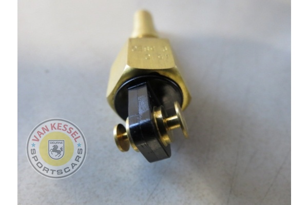

Since the CSV is controlled by the Thermo time switch. I took the TTS out. The resistance checked out low. The Bosch manual states the following values and mine are in bold:
Below 104F
G-Ground 30-40 24
W-Ground 0 0
G-W 30-40 24
Above 122F
G-Ground 55-85 60
W-Ground 0 98
G-W 55-85 40
I bit the bullet and purchased a new item which doesn't give any resistance values on my multimeter.
I have a spare CSV that I intend to test too. But first I want to see what the new TTS does. Although I don't want to void warranty on a €200 item. However, it came in a Porsche box stating the quality has been checked.
My car is not parked at my house and I won't have time to go out again until tomorrow afternoon. But I'd very much appreciate any help here. I feel that I've tested the components and probably renewed more items than I would have needed (in retrospect) but I must be in at around €1500 of parts by now and I can't figure out why the engine won't run well.

Thanks for the replies. Just to provide some answers. I did not remove or alter the position of the metering plate in the process. And this has not occurred before.
Like Tony says, the connections behind the air filter housing have specific colours and I'm afraid the problem is not as simple as mixing them up. Also there's no way the WUR can reach there. I've spent enough time around the assembly to know where all connectors go.
Why a Pierburg pump? Because there really good.
Also, I set mixture according to this manual. But it's hardly possible to adjust mixture when the metering plate is going crazy. I know you're supposed to tune mixture and idle speed with a warm engine. But in the current state there's no way my engine can reach operating temperature. Also the RPMs in the clip are around 800. Very low, very rich.
I noticed that the vibrating metering plate almost exclusively happens to 930 turbo engines. Why would that be? As for my fuel head: All rubbers and o-rings have been renewed in my FD. Including the pressure regulator parts:
I saw a mention of people who had said it was due to their fuel pressure gauges. But then elsewhere I saw them mentioning is was due to something in the end.
Most CIS topics are like a quest where I would be send off to measure this or that and then come back to exclude items or pinpoint the problem. What could I check at this point?
I can verify the position of the metering plate according to this manual:
I can take the Mercedes fuel pressure gauge out of the equation and hook up my CIS gauges again.
I can unbolt my FD and see if the plunger still moves freely and has no scoring.
Anything else? I wish I could swap out the FD but I don't have a second.
Should I still swap out the TTS or would I be better off returning the $200 item?

In your 77, there's an CIS elf called the thermovalve (Not the TTS) which can muck with your FP.
I haven't seen you mention checking it yet. Search for these threads.
Here's a description from the CIS Primer, if you haven't already seen it, #4 in the diagram.
https://jimsbasementworkshop.com/CIS/pages/descr_midyear.html
BTW I doubt it's your CSV. The other little CIS elf is that decel valve #8 which should not be doing anything except in decel conditions which I assume you are not testing under, but if misbehaving could muck with your car running well. So, I would consider eliminating it from the puzzle by taking it out, just for testing purposes, although many do it permanently since it is apparently for emissions and can hang up your throttle on lifting. Porsche got rid of #4 in later versions of the CIS.
Good luck !

Before the rebuild I did not have a thermo valve. I sourced an NOS item so I'm thinking it's not malfunctioning. But please let me know how I can test the item.
