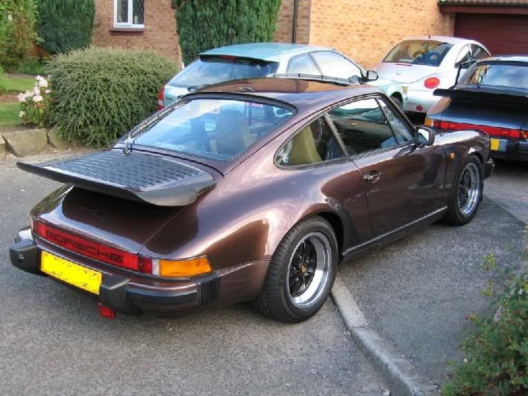

Whitechameleon's Avatar
Location: Manchester UK
Posts: 138
This is the one i got on mine, have got original factory birth certificate and it was supplied without one so this must have been fitted sometime after and before i bought it.

The only 2 factory tail options on a normally aspirated car from '75 to '84 were the fiberglass whale pictured here
1 piece, f/g ,w/ separate p/u lip, single grill
and the variant pictured here w/ the separate grill for the Ac condenser
1 piece, f/g, w/ p/u lip and 2 grills, standard on 930s from '75 -'77
and the poly-urethane one pictured here
2 piece, bolts on to a standard steel deck lid.
This is a "tea tray" type used on '78 - '89 930s
2 piece ,plastic ,w/ p/u lip that bolts on to a standard steel deck lid, never a factory n/a option but lots of owners did install them. The standard spoiler on all 930s '78 -89

Hate to disagree back, but M473 option thru '80 was the p/u spoiler, I had one on my '76 oem as well.
The M491 option which became available in '84 was the turbo look, which did include the "tea tray" spoiler.
The second vent on those cars was always for AC, which was standard equipment for 930s, that's why you always saw and associated them w/ turbos( I am sure that there were exceptions due to production line glitches). They also were used on factory AC equipped n/a models.
There weren't a lot of US cars w/ the 1 piece f/g tail but it was a rpo on ROW "sport" models. usually included w/ a package of Bilstein shocks and sport seats

According to Peter Morgan's book, "Original Porsche 911", on page 70 he writes "In September 1981, a revised and more elegant form of rear spoiler structure was fitted to the SC, with a large flat central cooling grille as on the Turbo, but cut back on the underside." September 1981 would have applied to the 1982 model year, btw.
He includes pictures of the two tails that were installed by the factory on the SC on page 71. Plain as day, the second white tail is the tail very commonly seen on the later Carrera. The caption states "...but further revisions for 1982 meant that the centre section was built up on its top surface, like the turbo version, and the underside was cut back..."
I tend to believe Peter Morgan on this issue due to the fact that he is a recognized authority on the 911 and has done years of research on the minutiae of the 911 and all its variants. I suppose it is possible that he could have gotten it wrong but not likely.
