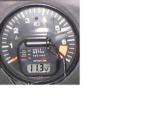

There are several diodes in the alternator. One of these usually controls the "idiot" light that is staying on in your car. If you blow one of these diodes but the alternator is still charging and able to hold its voltage when you load the system then you can still drive the car but its usually a matter of time before you will need to overhaul the unit.
This can happen when you jump the car or give someone else a jump or if anyone welds on the car with the battery connected or it can just fail. Bottom line is if the system holds 14 volts while loaded up (window heat on, A/C on, etc) then its working properly.
Without a volt meter in your car (I put one in the dash) and the red light staying on you have no idea if its failed while you drive or not. Other problem is that the red light is also the one that lets you know your fanbelt has broken and you are quickly cooking your motor with no cooling air. For this reason alone you should repair the problem.
Joe
Old 05-11-2003, 08:45 AM
Senior Member
Location: N. Phoenix AZ USA
Posts: 28,977
