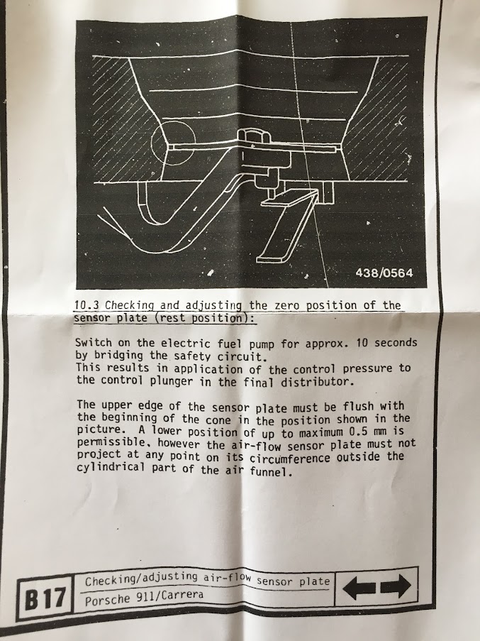

CIS is not my forte, but the sensor plate, when resting, is open quite a bit.. I've attached a photo to try to give an idea.
Is this correct? I would have thought it should be fully closed at rest?

No, there is a gap.

When doing a smoke test you have to seal the sensor plate after removing the cover, colloquially called the peanut. You can stretch a rubber glove around the sensor plate housing and use a rubber band or zip tie to hold it in place otherwise it’ll let all the smoke out.
And, yes there’s supposed to be a tiny gap to let some air into the intake… but just a tiny gap.

Sensor Plate Alignment.........
Mike,
It is next to impossible to do a sensor plate alignment with the motor installed in the car. The clearance between the sensor plate and the smallest diameter of the air funnel is so small that you need to use filler gauge (a strip of bond paper) or do a visual adjustment with a light source underneath the sensor plate.
For visual adjustment, you have to look directly above the sensor plate and with the motor installed it won’t be easy unless you have some optical tool. If you have the motor out, it would be simple.
Using a paper thin gauge is what I use for checking sensor plate alignment. Good luck.

ok, well the fuel distributor is out of the car, and looking at the pics supplied above, it seems that my sensor plate gap is HUGE. Also, the picture says that the plate should NOT protude into the funnel.. well, mine does... a LOT. I'll have a bit more of a look at the mechanism today, and also perform a smoke test on the airbox by itself, to see if it is indeed cracked as well.
Question: with the sensor plate gap so large, does this have anything to do with extra air entering the system, or do I still need to look for a large air leak that is allowing the extra high idle, even with the idle screw completely closed?

I lined cigarette rolling paper around the inside rim. It measures very close to spec. That was 10 years ago and no problems with throttle.

Cig paper.. ok.. that is very thin.. maybe a couple of thou?
My other question relates to the movement of the plate. Lifting it is resistance free, till the halfway mark (approx)... after that, there is some resistance that feels like it is pushing against pressure. The assembly is out of the car, on the bench, and disconnected from fuel / pumps etc, when I do this.
Is this normal? Or should the plate move freely up and down for the entire movement?

another CIS technical document
I just had a fuel distributor rebuilt by CIS Flow Tech. Here's their instructions for setting up the sensor plate:

Thank you for posting this.
There are a couple of posts now that show the plate alignment like that.
Mine DOES protrude into the upper cone so clearly it is incorrect. I need to examine how it is aligned.
