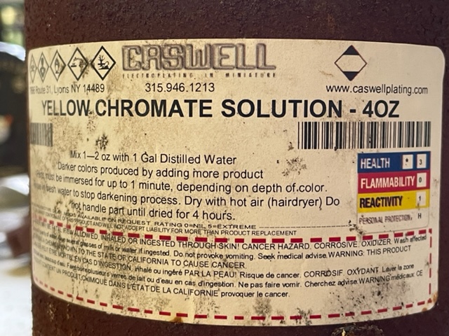

Old 06-16-2022, 02:46 PM
Under the radar
Trackrash's Avatar
Posts: 7,129
Not sure if this relates, but I used a chromate conversion from Caswell. Caswellplating.com. Gives that subtle amber tone. Followed by a coat of Gibbs. Not sure if it can be shipped to Europe.
Gordon
'71 911 Coupe 3,0L outlawed
