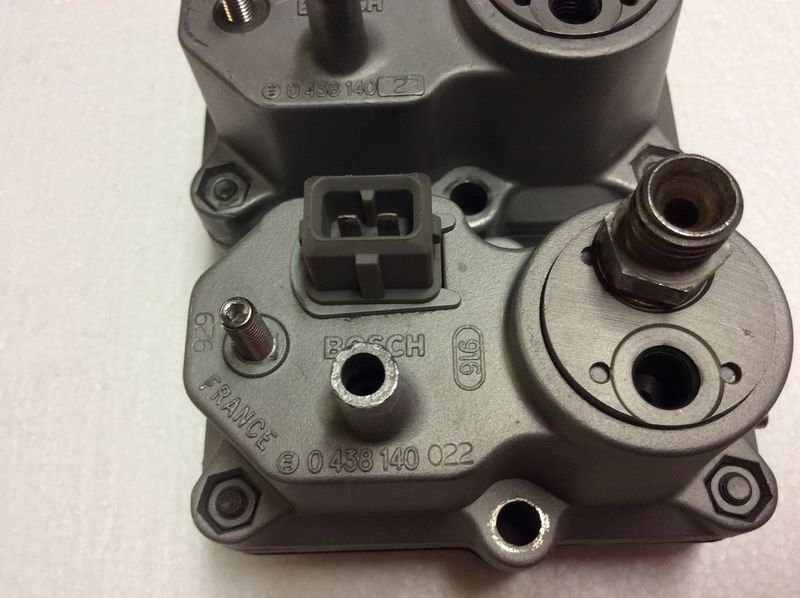

WUR Identification...........
MD,
What is the Bosch ID # (0-438-140-XYZ) on your WUR? You need to test and verify the settings of your WUR using a pressure gauge if they are still in specification. If they are out of spec, you need to recalibrate the settings in order for the WUR to work correctly. Keep us posted.
Tony

MD,
You are not doing the right way to troubleshoot your CIS problem/s. So far, all your WUR’s exhibit out of spec for control fuel pressures because you made the wrong adjustment procedures. If you would share with us the Bosch ID #’s of these WUR’s, people with experience could give you a meaningful advise. So far, you have been unresponsive to this request. Good luck.
Tony

WUR ID #’s.........
Originally Posted by MD540iT View Post
one of the WURs # is 0458140 (916)
MD,
Go back and review the numbers on your WUR. Clean and read the numbers again. It should be 0-438-140-xyz. The last 3 digits identify what particular WUR you have. 916 is the casting number, ignore this one. What we need are the last 3 digits (hand stamped) on the WUR.
The pictures below are examples:

Join Date: Mar 2002
Location: Philadelphia, PA
Posts: 12,607
one of the 3 i have ends in 091
What are numbers for the other 2 WUR’s you were playing around? Why are you too secretive about sharing these information? How do you expect people to help you if you are withholding critical information? We don’t even know the year and model of the engine. Are you working on a 924?
Tony
