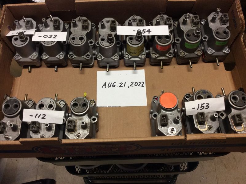

the last 3 of the other WUR that is out is 062

Ok I just went and installed the WUR with out the "warm up" parts. initial pressure was 45. started normally. I tried to drop the pressure with the allen but it didnt drop any more. (I was able to raise it however)
SO next I took the bottom half of the WUR off so there was no spring/pin, just what ever it naturally would be at and that was 42 psi. didn't drive it or let it get hot, but might try that next.
c
oh, the allen screw you are messing with.
i assume these WURs have not been modified to be adjustable.
if so, and the allen screw you are adjusting on the bottom is just screwing up the way the WUR works for a vacuum controlled WUR, but i dont see a spec for that pressure.
also, is looks like these WURs do NOT lower the pressure under boost. perhaps these are for early turbos like 76-77. i dont know.
the 054 and 153 WUR are for the later turbos and they have boost enrichment. which BTW is 2.8bar. normal CP is 3.6
the 112 also has boost enrichment.
i also assume you have the cast iron head and that this is a 924????
tony is a great guy.
be patient with him as he is also very busy, is extremely knowledgeable and has been doing this for a very long time. his patients can seem short, but he is good.
remember, both of us can only work with what you TELL us, we are not there.

ok
some i found out a little bit
the 062 is for a 924
the 916 is a "vacuum" WUR. that is, vacuum raises the CP, no VAC lowers the CP to 2.7bar. which is where it was at. the allen screw you were messing with changes how much vacuum is needed to raise the CP. this one is bad because you are going rich WAY to early in boost, actually BEFORE boost comes in. i think the 054 goes rich around .3 bar boost and most people want to raise THAT up so it go rich later.
find you a 054 or 153 (i dont remember which one is better to be modified ) (of course i have the other one). have it modified to change the pressures but LEAVE THEM ALONE from where they are set when it is modified UNTIL you have everything else working right. then and only then make changes to the pressures to improve performance..not fix it. IE start with it a spec
stop thinking about that heat soak crap and modifying from spec to "fix" it

Ty,
Were you talking about these WUR’s?
I wish I could work longer hours to catch up with the demand for these WUR’s. For almost a month now, my work schedule is 6:00 AM to 10:00 PM except Tuesday and Thursday for my tennis games (6:00 ~8:00 PM). And don’t forget that I will be 80 years old very shortly and still beating guys younger than my children.
You are right about my patience. Sorry, I’m just a human being with many faults.
Tony

WOW tony.
yes. 930 WURs
i had to do some searching to find out about the ones he was talking about.....after i had written the previous post.
i need to come up your way and come see you again.
