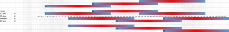

pampadori 10-27-2022 01:43 PM
My 3.0 with stock SC cams and small ports running out to the red in 1st gear. While the heads and cams are stock, the ITBs, headers/exhaust, and flywheel/clutch are not. Sounds very similar to ian's video though. I think i also get an advantage from the 2.7 crankshaft which has a quick-revving nature to it.

When I do my cam timing i use the degrees at .050" lift on the intake valve .
I often forget to then do the @mm for Z1 just for reference , for the other school crowd .
As you retard the cam the total hp is increased and it is moved up in the power band , advance it and you will increase the TQ and feel in the lower revs , with smaller total HP numbers , band width is about 400-500rpm from one extreme to the other .
So with the 911sc cams the numbers I like are between 3 degrees ATDC and
8 degrees ATDC @.050". As you retard the cam timing the likely hood of the
valves hitting the piston decreases . There is no rule that says one way is correct ,
it's just what you like .
Just some thoughts
Ian
For me 2800rpm should feel great , strong , fun, and more as revs climb , also there are good cams and lousy cams .
Yes the lower timing number @mm is a retarded number , higher number is advanced

Bill Verburg 11-04-2022 08:10 AM
Originally Posted by pampadori (Post 11838788)
Does this cam timing effect on where the powerband resides mostly have to do with the exhaust velocity/scavenging "pulling in" fresh air and fuel where there is overlap with the intake valves? Just trying to understand the "why" this does what it does.
And thanks for compliment Ian! I can't recall where i set the cam timing when i rebuilt it to be honest. It was a cold garage in the middle of winter 5 years ago and i just wanted the car to move on its own power again. I probably went by whatever was in Wayne's book no telling.
2 things
1) w/ a muffled system any 'scavenging' effect is minimized no matter what
2) scavenging does depend on valve overlap and w/ stock SC cams there is little to no overlap, yes retarding cam timing moves the power upp the rev range a little, most retarded was the '76/77 Carrera 3.0 spec here was .9 - 1.1mm, this was also used on the '81-83 RoW SC, most advanced was all the others @1.4 - 1.7mm, 3.2 split the difference @1.1 - 1.4mm
stock SC valve events
http://forums.pelicanparts.com/uploa...1667574268.gif
compare that to SCRS valve events
http://forums.pelicanparts.com/uploa...1667574363.gif
when you have a properly designed open exhaust w/ lumpy cams here's what you get, scavenging aka the 5th cycle
http://forums.pelicanparts.com/uploa...1667574630.gif
