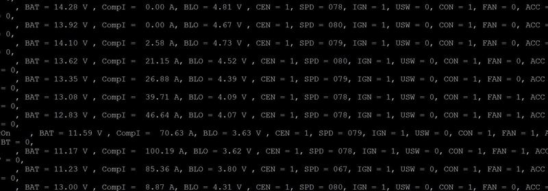

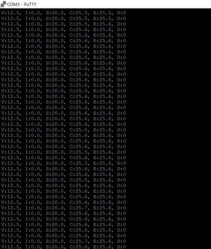

I've run putty, checked functions. Was able to turn on the compressor using Putty, condenser fans, etc.
Below are screen shots of the system when its running.
Here is the issue- What is happening is that I can hear the compressor run (its a weird pulsating sound?), but then will turn off. This can be seen under the DIAG- Comp I where the amps can be seen going up and then going down. It will cycle through this. Start- Stop- Start - Stop.
We have pressure gauges hooked up, what is really interesting is that there is zero movement of the gauges. I thought that there might be a blockage, but Warren said that if there was a blockage, then the pressures would build up as the Freon moves to the blockage. Its almost like the compressor isn't moving refrigerant. There is zero movement of the gauge, except over a bit of time, it climbs up, because its getting hot.
Has anyone experienced this with their system? I've emailed Alex, but thought I'd ask the collective in case someone else has experienced this issue.

With that said, I remember hearing the compressor kicking on (that pulsating sound which coincided with the spike in amps on Putty). Is there a lag in the pressure building up? I'm zooming into the picture here with the amp readings for the compressor and fan.
I know that with a conventional compressor, pressure changes happen immediately when the compressor kicks on.
Thoughts?
COMPRESSOR AMP CHANGE-
CONICIDING WITH COMPRESSOR AMP INCREASE, FAN TURNING ON AND THEN OFF (ASSUMING IT CAME ON, WILL PHYSICALLY CONFIRM..)

Yes, the compressor is 'soft start' so it takes a little while to build pressure. The compressor current is proportional to the pressure so we use the current reading to run the condenser fans ( as you note FAN=1 indicates that the ECU is asking for fans to run).
If the fans don't run due to wiring errors, the condensers will heat up and the pressure will go higher. This in turn will switch the compressor off for safety.
When the system is running properly, the compressor will run continuously.

Jonny, to follow up, we ran the diagnostics again. Fan previously wasn't coming on because of a loose fuse, that got addressed, now FAN=1 does turn on both the condenser fans.
When i run CMP=5, the contactor does connect, but i don't hear that weird sound of the compressor running.
When the car is running, when the AC button is pressed, the fans kick on, i believe i also do hear the compressor kicking on, but there is no change in pressures, and the compressor does 'kick' off from looking at the amp values on the RUN file.
Attached is the RUN file.
Close up-
Thoughts on next steps?
Thanks.

The current is rising faster than I would expect. Has it got too much refrigerant? What is the pressure at rest (e.g not running)?
