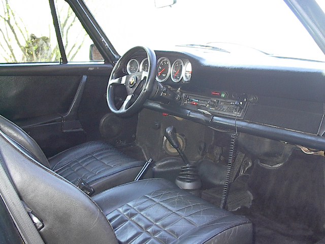

where else can I put front speakers..
Just put in RS door panels. Look so screamin I don't want to put my speakers in the doors. What other options are there? I have the rears still, but looking for a place to put fronts...

Old 06-06-2003, 08:42 AM
Join Date: Feb 2002
Location: West
Posts: 8,436
Kurt, can we see a pic of the install. Since I have a cab like you, I woudl like to see how it looks.

Kurt-
I seem to recall someone having small tweeter-type speakers and mounting them just inboard of the windshield pillars, along with mid-range speakers tucked just below the dash.

When I bought my 70 it had these speaker walls custom installed. They worked so well I transfered them to my 76. If you want I could stencil you a blueprint and your could cut them out of whatever material you want.

needlevalve,
The lower kick panels are one of the best places to put a set of speakers for imaging. If they are angled correctly, the staging is fantastic. I planned on making something similar out of fiberglass when switching to a set of RS door panels.

What TurboRuf said and Needlevalve showed. It actually sounds awesome (in pretty much any car) when they are mounted there.
Make them out of wood and f'glass - good fun. I guess my speaker pods weighed about 3lb each with no speaker and were seriously over-engineered. Use a good quality 5.25" and a decent amp (50-100wrms /speaker) and you wouldn't know it was such little speakers. I had that sort of thing plus a sub (crossed over at 90hz) in my peugeot 106 (cabin is a small as a 911) and it sounded great and went way louder than I would listen.

Old 06-06-2003, 10:47 PM
Join Date: Dec 1999
Location: Los Angeles
Posts: 2,479
Send a message via ICQ to Kurt B Send a message via Yahoo to Kurt B
the pic
the pic
-kb-
