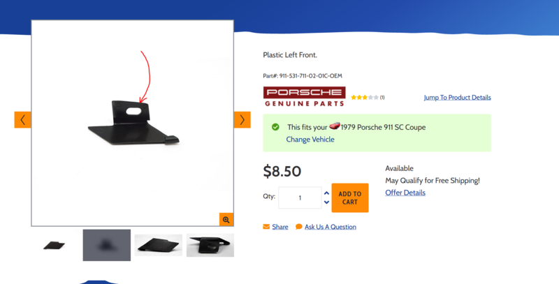

Anyone know the part number for these little guys that go on the windows, have her all taken apart and one of the clips broke. See the attached pics.. they’re like transition plastic clips… they mount in two places
Thanks in advance you guys are the best.

Also need some of the butyl tape to replace the gummy stuff you see there. Part number is 000 043 129 00.
One of these rolls is plenty to replace an entire car's worth.

How many rivets?
So I already bought the roll of butyl tape, wasn’t aware that I needed it below the front vent glass, it was so dried up and crumbled that I wasn’t sure what it even was, or is it just behind the plastic clips to hold it in place?
How many rivets do I need? also not with the car so I can’t see exactly where the rivets go.
Bought all new window seals, weather strips, felt for inside and out, so many tiny parts you don’t realize….
Thanks for those part links I could not find them.

I believe all you'll need is 2 for the frames (1each side), they hold the following set in place to the door frame (these are the ones closest to the front of the car)
