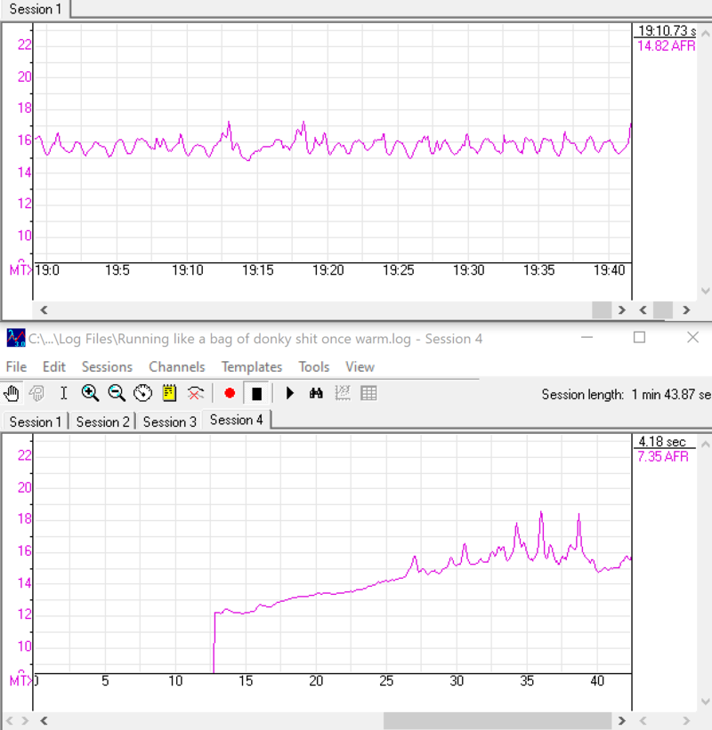

AFR set to 14.3-14.4ish while
Here is the issue as best as I can define/pinpoint it.
Engine runs well as it is warming up. Even into closed loop (a bit of oscillating idle but runs ok)
Once engine is fully warm/heat soaked engine runs lean, starts to backfire a bit off idle.
Runs well at speed and under load, with the occasional stumble.
The main lean off idle has been happening in varying degrees since I can remember. It seemed to get worse after a recent rain storm where
fuel went very lean (o2 sensor had taken water in) I was able to drive home in Open loop with o2 sensor unplugged. Recently the car has driven its best
with the o2 sensor unplugged and a bit rich.
Need some CIS wizards advice, to this point I have studied and read many of the available books on the subject, including
Porsche Fuel injection manual; Probst - Fuel injection and Engine Management: Watson - How to tune & modify Bosch fuel injection - and many many many responses to others CIS woes...
Im having a hard time seeing what has changed to make the engine running characteristics different once fully warm.
Control pressure stays the same - No leaks (Even smoke tested while hot) - Lambda seems to be functioning as it should..; the level of patience I have for continuing to mess with CIS is dawning.

No expert here, first thing that comes to mind is ignition as you seem to have covered all else.
Clean the grounds / powers to CDI box, there are some grounds straps on the side wall of the engine bay as well.
Contacts for CDI?
Coil still good? Lots online about coils acting up at higher temps.

The O2 sensor voltage (too positive) is causing the Lambda unit to lean the mixture too much. For testing only, you can always disconnect the Lambda unit and
richen the mixture. You'll have hard starting when cold, and a little flat accel when warm. If you still have the problem, it's not Lambda electronics related.

I know you said that you think the OXS is operating as it should. You also said that a rainstorm caused the oxygen sensor to "take in water." That should not happen. The O2 sensors are designed to be waterproof under a car. I'm thinking you have a bad O2 sensor. They do wear out eventually and their output lags the actual oxygen value in the exhaust. If it's over 100Kmi old, replace it. If it's not that old, try replacing it anyway.

Connect a DMM with duty cycle option to the white/green wire (pin/terminal 17 of the ECU). Red connector of the DMM to GND and the back connector of the DMM to that green/white wire. Connection here is inverse cause the duty cycle of the ECU affects the GND connection of the frequency valve.
Now check all states when driving where you say that the mixture leans out ... and report here.
Also have a look here at the 930/16 engine workshop for proper initial setup and for solutions on issues with the lambda system:

Andrew - (I have spent much time on your site, thanks so much for all the great information!) Ive been driving around with an oscilloscope setup in this fashion for a bit. Ill give it another go once I re "baseline" the CO and Idle and let yall know what I find.
I also have datalog showing the issue if thats at all helpful.
Top is running well between 45-55% Dwell - Bottom is after heat soak startup - running not so well.
AFR - Running too lean! This was indicated in post #9. You also stated this in your first post. Most likely your CO is below 1%, and NOX is high. Good hydrocarbons, though!
Way too rich for too long.
Again, analyze the problem first without the Lambda ECU, and a small CW turn of mixture screw.
I had to check what "heat soaked" means, and ... now to me it seems your residual pressure could be below specs. As regarding to your latest info: if engine is warm duty cycle swings around 45 and 55 % with a resulting proper AFR. But after heat soak startup it gets messed up.
So ...
1. Do what mysocal911/Dave said, means if with disconnected sensor and therefore ECU in closesd loop mode and by this with fixed duty cycle, check if problem still exists.
If yes, then ... its cause the ECU, even in closed loop mode, enrichens with 65% duty cycle directly on start up, which corresponds to your second graph where at the first 15 secs the AFR results too low.
2. If problem still remains, check all Pressures
https://nineelevenheaven.wordpress.com/adjusting-the-warm-up-regulator/
especially the residual pressure if within spec.
3. If problem still remains, proceed with the suggestion/info Thomas provided. But I don't think on the first view that it's a false air issue cause, regarding to your second graph, after 15 secs on start up the AFR rises to proper values
And last but not least ..... with the second graph you posted it would be essential to know how the existing duty cycle values are corresponding to "that" graph. This would give a precise diagnosis of how the ECU works, means if it trys to compensate false air, or too low residual pressure or whatever ...
