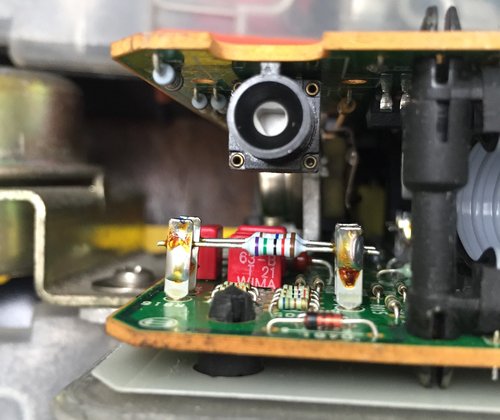

Old 05-01-2024, 08:01 AM
Discseven's Avatar
Join Date: Oct 2012
Location: Miami, FL
Posts: 4,455
Yesterday: Adjusted idle setting with warm engine. Jumped BC and turned idle screw 1 ¾ turns counter clock wise. Idle now at 1,000 rpm. (Shut down and left test drive for Wednesday.)
Today / Wednesday: Cold starts on first crank. Terrible idle right away. Bouncing. Then sometimes holding at 800… then 1,000… then 1,200. Almost stalls and catches itself a couple times… finally stalls. Restarts on first crank. Test drive… warmed engine to 210 dF. Pulls clean in first and second gear. Held steady throttle in 3rd gear heading to highway and after a second… bucking. Canceled highway. Heading home. Warmer engine gets, worse it runs.
Thought about pulling Ox sensor and having a look at the wires to see if they are stranded or solid. Doesn’t make sense to fiddle with this anymore. New heated sensor ordered.
Will return idle screw and air flow meter’s disk-spring to their original positions. Leaving ECU fuel adjustment on #3. Will open ECU to check chip status. After new Ox is in… test drive.
Will report on run of engine. Then check mpg.
Update - From the grapevine word is this oxygen sensor inclusion is needless! Easy enough to disconnect it and see what happens.
Appreciate the input. Is now too much to respond to as I like to do. Know that I read it all.
Karl ~~~
Current: '80 Silver Targa w /'85 3.2. 964 cams, SSI, Dansk 2 in 1 out muf, custom fuel feed with spin on filter

Be aware that a cyl that is not firing will cause MPG issues if you have the stock O2 sensor connected. Here's why:
A cyl not firing is a O2 pump, the O2 in the air fuel charge goes for the ride straight out the exhaust.
This extra O2 is then mixed with the exhaust from other 6 cyls.
Then the exhaust runs past the O2 sensor and the sensor sees all this extra O2 and thinks lean condition.
But in fact the other 5 cyls are not lean they are burning just fine.
What happens next is the O2 sensor sends this false lean condition to the DME.
Now the DME tries to fix the lean condition by riching the mixture to try and correct the false lean condition.
It's very common to see MPG drop by 20% when this occurs!
Are you certain all 6 cyls are correctly firing?
And do you have the stock O2 sensor plugged in?
You really need to get a WBO2 gauge to properly diagnose what the AFR is at idle, part throttle driving and WOT.
Sal

Old 05-01-2024, 12:28 PM
scarceller's Avatar
Join Date: Oct 2006
Location: Southern MA
Posts: 3,972
If cold start is hunting for idle up and down it means mixture is to rich. The reason it hunts is because rich mixture causes engine to want to rev up and as it revs up it then hits the fuel decel fuel cut limit that's set at around 1300RPM. When the idle hits 1300RPMs or so the DME instantly cuts fuel and now the idle speed drops like a rock. And the cycle repeats.
So why are you running rich?
To diagnose these issues you need to diagnose fully warm and you need a decent WBO2 gauge so we know the exact AFR.
Stop messing with the AFM spring tension, you are likely trying to tune the AFR around another critical issue.
Changing the spring tension is a very bad idea because it effects AFR a lot more at high air flow rates than it does at the low rates.
If anything, move the other adjustment so you move the carbon contact point further down, this will lean the entire air flow rates evenly.
I can help further if you PM me, it's hard to diagnose here on forum. I can help and if we fix the issue come back and report the fix.
Yes, please unplug the O2 sensor and leave it unplugged during all diagnoses, you only plug it back in once you fixed the core issue. And if you don't have a Cat converter you don't need the O2 sensor at all.

Old 05-01-2024, 12:36 PM
Discseven's Avatar
Join Date: Oct 2012
Location: Miami, FL
Posts: 4,455
Sal... Appreciate all the info.
Bottom line here: all things point to the soldered extra wire I spliced into the Bosch Ox length of wires in order to extend them to reach the SSI bung. Discovery made (in thread) is those wires should NOT be soldered according to Bosch. Adjustments I made will be returned to the original settings. I'll disconnect the Ox and test drive the engine. If good performance, will check the milage. Ultimately I'll use a friends tail pipe meter to check the air fuel ratio.
You asked about the engine running on 6 or 5 cylinders. Rebuild was recently completed and aside from this milage issue and now the engine running poorly given my adjustments, there's no doubt all 6 are firing. That said, thanks for explanation in this regard.
Your offer to PM assist. Much appreciated / Thank you. I believe the situation's under "control" for the time being. We'll see if that bears out in a few days

Old 05-02-2024, 01:33 PM
Discseven's Avatar
Join Date: Oct 2012
Location: Miami, FL
Posts: 4,455
Update
Today: Started engine with existing adjustments that proved faulty yesterday. Start on first crank. Erratic idle... Shut it down.
Returned Air flow disk to original position. Disconnected Ox sensor. Start on first crank. Even idle. Jumped BC and adjusted idle screw clockwise 1 3/4 turns (back to original position.) Remove jumper. Shut down. Start up on first crank (slightly warm engine.) Even idle at 800. Test drive... warm engine to 210 dF. Test pulls... to redline without hesitation every time. ...Making progress.
With faulty settings (from and tested yesterday,) engine would not tolerate being driven in high gears around 2,500 rpm without bucking. No bucking in high gears at that rpm level now after returning original settings and no Ox sensor.
Checking fuel milage next.

Opened ECU/DME and I didn't get to far. Appears to me there are soldered connections that don't enable the 2 boards to be easily separated to look "inside." Rather than screw something up messing with it, and given the engine running well, am leaving the chip question unanswered for the time being. If someone can tell me how to separate the boards, I'll go back in.
Pics of ECU/DME:
Rotary fuel switch that was in position 0... Is now in position #3. This was the first adjustment done a number of days ago. No change was noticed. Supposedly this position results in 3.9% reduced fuel flow.

Moving the FQS from 0 to 3 does pull fuel out, about 3% leaner. But doing this is often a red flag that something else is off.
I did not ask, what altitude are you at? If Miami then sea level so no need to discuss.
DME boards can be separated, watch my video:
https://youtu.be/GAo01_454IY
