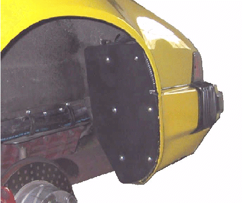

I've got a fan cooled AC primary condensor in the drivers side rear quarter (were the oil tank would be if it were on the drivers side). The discharge of the compressor goes to that one first and then to the decklid condensor. It works well. I like the idea of rejecting the bulk of the heat load in the fender instead of the engine lid air intake. Giffiths sells that setup. My car came from TX and the PO spent some money to get the AC to work. Summer time in Dallas and no AC = sweaty driver?

Scott, the previous owner of my '78SC, Seadweller, installed a fender mounted condenser in the driver side rear fender. It is behind the tire. I also have the decklid mounted condenser, and so far it has performed very well. I have never tried to cool the car it has been in the hot sun, though.

For what it is worth I had a 911 owner call in today and he Told me that by blocking of the outer vents his A-C blew much cooler out the center vents, He was from Las Vegas so I thought I would pass it on.Below is a photo or the Rear Fender mounted Condenser:
