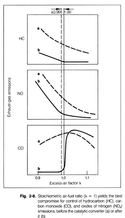

Let's talk a bit of chemistry here. T
his is the chart from Bosch Fuel Injection & Engine Management (thanks Steve W). The solid line is with a cat and the dotted line is without one.
Anyway, you can see from this chart that by making the mixture more lean (less excess air), you drive the CO down, but the NOx and HCs go up.
A question is how do your HC's and NOs look. If they are high, it is possible your catalyst is dead. If so, you may notice that the CO is the one most greatly controlled by the catalyst and this could be why you are not passing.
