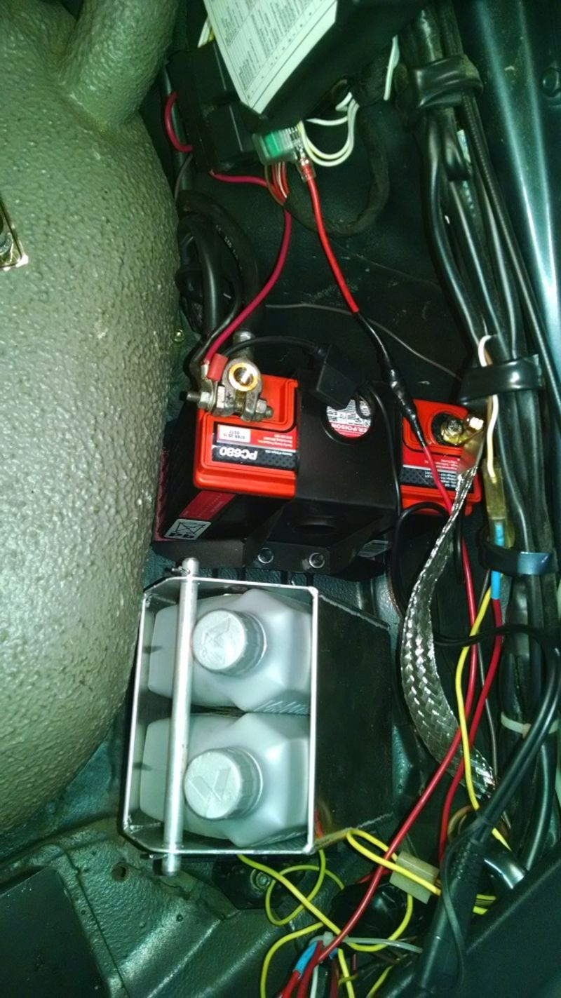

I recently booted out a perfectly good and almost brand new Interstate battery in favor of an AGM. I welded up a tray that replicates the footprint of the original battery and welded an off-road box to it. Even had room for a couple quarts of oil...

Originally Posted by douglas bray View Post
neat solution
