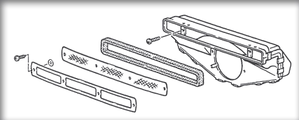

What do you racers do when you've removed the front vent fan and now have no use for the front vent behind the hood?
I'm tempted to just use some black duct tape and tape it off but that seems like a hack way to do it if you ask me. I need to block off the vent to keep bugs and rain from getting into the trunk and messing things up.

Easy, just use a piece of thin ally which is easy to bend into the same curvature as the mesh.

here is a pic

Cool! Thanks for the tip, Steve.
Did you do anything to waterproof it?
Old 12-28-2003, 07:09 AM
Location: Edenvale, South Africa
Posts: 299
I used a bit of silicone 'bath' sealer around the back, but that was all. So far it has been waterproof.
