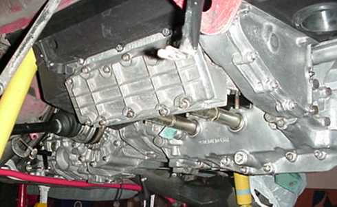

I just jacked the 911 up, and put 'm on jack-stands. (1)Toke a old srewdriver to get the hardend dirt of, in the corners. (2)Then use a plastic brush (or buy one, the type you use to do the dishes). (3)To remove remaining dirt with Green Soap. I removed the rest with a Highpressure Cleaning Hoose. Finaly i did step(2) ones more, only then with Engine Cleaner. Repeated step (3) to finishe the job ! See the righthandside of the engineblock. Leftside almost done.

Citrus cleaner like Wurth or Xenit tackles the underbody wax/cosmoline crud. You gotta scrub it though. Then a shot of Simple Green thins out the slime created by the citrus. Soapy water (I like Dawn dishwashing liquid) rinses everything clean.

The camera flash makes it look brighter than in reality. It's pretty dull. But there's no crud on there and that's fine with me!
Gotta watch out for that Xenit stuff (made by Stoner) I mentioned. It's in a spray can and the fumes are pretty strong. A drywall mask helps you battle the fumes a bit. Rubber gloves aren't a bad idea either.
