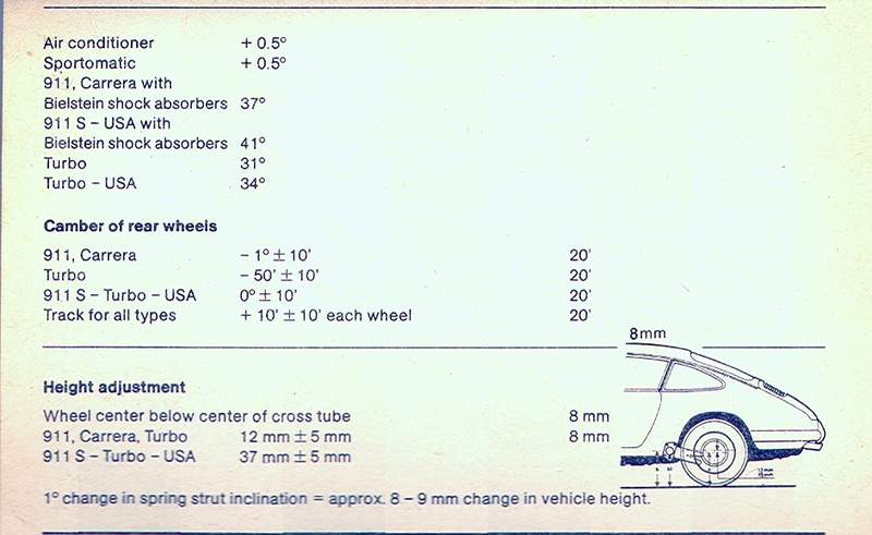

Here are the documented spec reference points.
front: Wheel center above middle of torsion bar
back: Wheel center below center of cross tube
get on a flat surface, measure the heights to each point and subtract appropriate pairs.
I don't know what year you have, but my 78-81 book 930 values are:
f: 94mm (85 US)+-5mm, max L/R diff of 5mm
r: 12mm (37 US) +-5mm, max L/R diff of 8mm
At front the axle is above the bar and at back the axle is below the tube. If there's no misprint in my spec book, the US settings have alot more rake than the RoW cars.

Here is the factory method
Bill Verburg

Bill posted images of the pages I quoted. If you think your bushings are worn out bad enough to create more error than the 5mm tolerances, I would be worried less about height and more about when they might fall off on the highway
