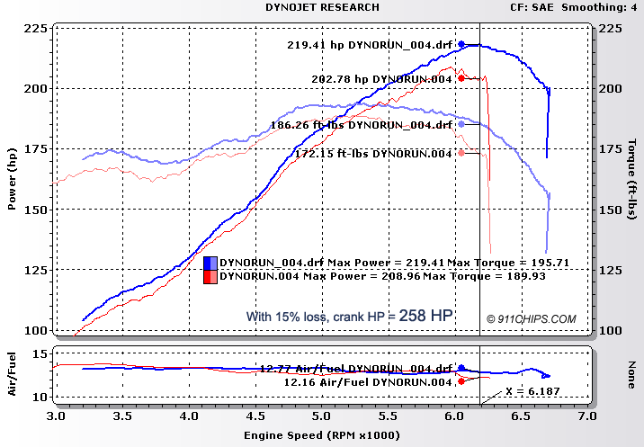

Originally posted by Lorenfb
"I spent $1200.00(this includes dyno R&D time) on my exhaust, $4.39 for the holesaw to make my airbox a "cup" airbox and 230.00+ shipping on the chip."
As usual, we don't know what really does yield what in torque or HP.
So, where's the original totally stock 3.2 graph of torque & HP? Let's
have a real reference point.
Per Loren's request:
Red: stock chip
Blue: 911Chips performance chip
No other changes in between. Same dyno, same day. Any questions?

hahahaha, i love the flashing banner!!
awesome increase with the mods! i cant wait to start turning wrenches on my motor with my dad

Wil Ferch 08-26-2004 05:48 AM
One major issue I've brought up before...
This dyno can calculate HP on a number of different bases. One way...is to measure the actual HP ( through a torque calculation) based on *that day's* humidity, temperature and site elevation. I notice that someone asked that question and got an answer on that basis.
The other...and in my mind more meaningful way to quote dyno numbers...is to have them reported to SAE-standard basis. Off my head I don't recall the normalization factors, but I believe the correction would bring you back to a sea-level, 70 degF, 50% relative humidity basis. The clue would be to look at the margin of the printout and see if it says "SAE HP" or such. Also...the bottom of the graph would show a "CR" or correction-factor to bring that dyno run into compliance with the SAE standard.
I've successfully compared identically-configured cars that were each run on DynoJet 248C's at different locations in the country, and was able to find good agreement in the runs this way...even if one of the cars was in mile-high Denver or whatever.
So...what's the basis? We may have to re-adjust our thinking of how good ( or bad) these numbers are when finally corrected to SAE standards...

Wil,
Here is a screenshot from the Dynojet run viewer showing that these runs are with SAE corrected data.http://forums.pelicanparts.com/uploa...1093531842.jpg
The run #4 is with a stock chip, run 6 is with the aftermarket( Steve W) chip.
