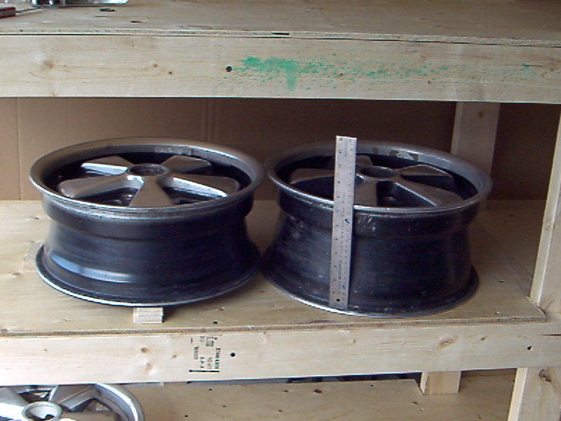

The difference is only in the inner lip. From the mounting face out they are identical. All they did was stretch the inner rim.
I'll try to post a pic:
On the left is an early deep 6 sitting on 1" wood block.
Early deep 6s are worth more than late 6s in comparable condition.
