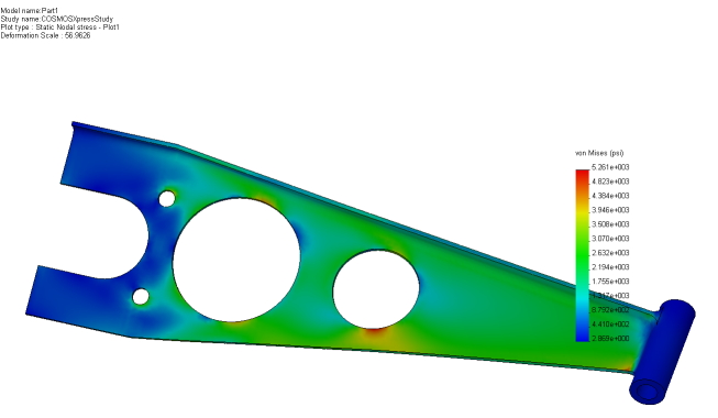

island911 04-26-2005 10:45 AM
dd, Why Aluminum?
Take a hole-saw to your steel cross-bar/motor-mount
Repost: (from years ago)
Tyson, you're kill'n me. ;) . ..
Also, you know that mod' (read: hole saw holes) you did to the rear carrier arm (motor-mount span). It became quite the topic of discussion. So much so that I did a quick computer stress analysis of your modification (which is why the laptop was in front of me in the above group picture.)
Before:
http://forums.pelicanparts.com/uploads/crossbarNh.jpg
After:
http://forums.pelicanparts.com/uploads/CROSSBAR.JPG
Hmmmm; I guess your thinking was right. . .if it's good enough for an RSR . . .

island911 04-26-2005 11:12 AM
Ah, the transmission cross member.
fwiw, I've seen the transmission cross members punched full of lightening holes (as above) to good effect.
The thing is, those steel pieces get rigidity from the shape. Proper placement of lightening holes is not taking away a lot from either the stiffness, or strength of the structure. (look at all of the"open space" of say an old railroad bridge . ..for example)
