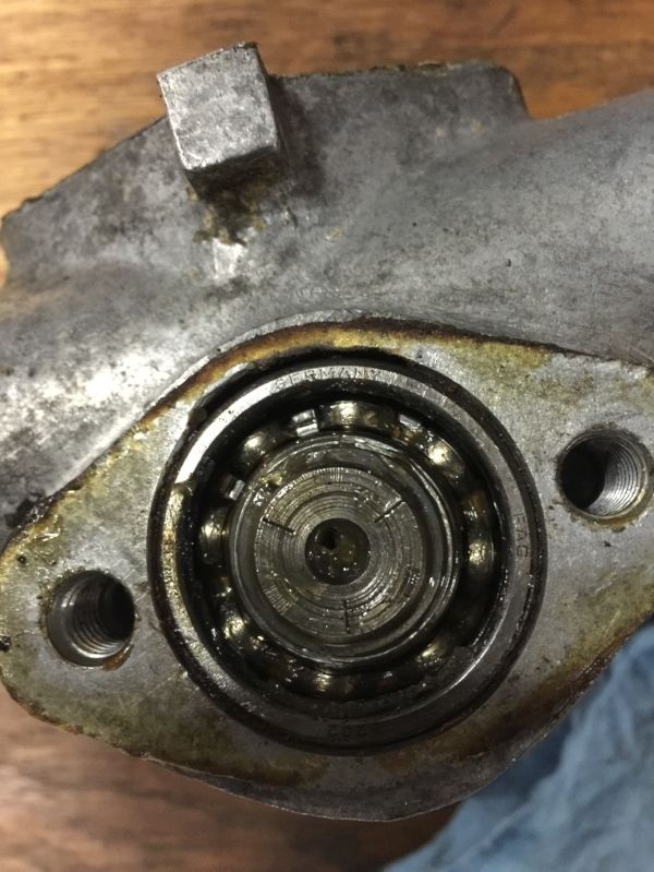

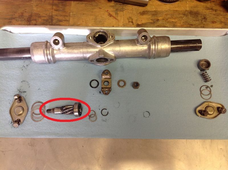

On to cleaning the steering rack... also decided to open it up and clean and replace the old grease. Question that I have is (and probably missed it in this thread) how do you remove the gear/shaft/bearing assembly? Do you just tap it out? Any circlips holding it in place?
This is what it looks like when you take it out... I just need to make sure that I do not damage anything in the process... so looking for clarity on how it comes out.
Replacement bearings #1712 and #6202 from EB Atmus Co. in the US.
Search for 1712 | E.B. Atmus Co., Inc.
Search for 6202 | E.B. Atmus Co., Inc.
HK-1712 NEEDLE BEARINGS-SHELL TYPE-OPEN 1
6202-SKF SINGLE ROW BALL BRGS 1
Bearings, Motion Control, Power Transmission, Pneumatics | E.B. Atmus Co., Inc.
EDIT: Nevermind, found a thread that calls this out clearly!!!
rebuilding the steering rack and adding "turbo" tie rod ends
you will find more shims and also that there is a circlip holding the pinion shaft in place. (that's what I'm pointing at with the scribe) The tool shown is one I got at Sears and it's used to remove that clip.
Once you remove that clip, you will find even more shims. Here is a photo of the clip and also the shims that were between it and the bearing inner race.
Now you can tap out the pinion shaft.

Originally Posted by Kraftwerk View Post
Don't forget to check your bushing on the shaft...
"The body of the bush is made from 7075-T6 Aluminum and hard anodized. The bush in Oilite which has been oil impregnated we have fitted a pair of R21 Rotary seals to keep the crud out - and they fit correctly."
^Sounds like a great upgrade , where can I find one? The puck itself can be polished if it has signs of "fretting" .. : ) On the other hand I would love to try one of those " PTFE POM pucks" to compare drag/lash.
Also, gaskets for the two covers can be cut out of 'gasket material'. Gaskets are, in fact pictured in the exploded parts-diagram from the factory (?) manual. Keep in mind, the thickness of the gasket will change the "lash-spec" or 'feel' of the spring loaded bushing..
On the side with the puck, where it is spring loaded, I suggest taking some stress off the little cover-plate by using a c-clamp to hold the cover-plate on while you thread those two bolts (which hold the cover on) Otherwise you could cross-thread or strip the bolts.
I am no expert, this is just stuff I thought about while overhauling two racks recently. It was fun!
Drive safe!
