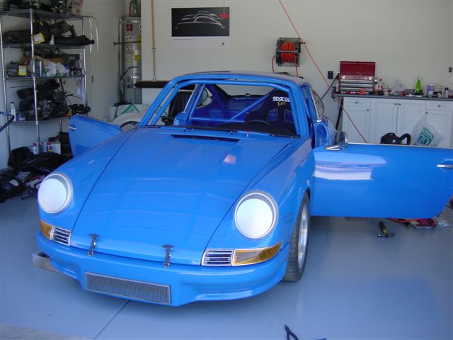

Here is my old 3 car garage I did with the rustoleum product. turned out great.... Prep is key to having it look good. I used everything out of the box. Nothing more.
It sure made it more fun working on the car. The crap part was moving the junk to one side of the garage, then moving it again to paint the other side.

Chad...they BOTH look great. The car AND the garage. That's the color I'm going for with the car...is that Mexico blue?

Thanks- The color looks washed out from my camera. Its more blue than that. Paint code L305 or 305 "Royal Blue" AKA "Arrow Blue" Both are the same color just different names.
Fishcop and I have ownership rights to it If you paint your car that color we both need to collect $1000 USD as royalties
On my computer screen, this picture best represents the color of the car in person.
Do the garage BEFORE you put the junk in it. You cant drive on it for a week, but you can put stuff on it after a day (boxes, etc)

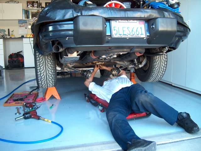

emptyo- Prep is everything, if you don't etch whatever product you use will peel. I used Griots floor paint, it's an epoxy 2 part paint and hard as hell. I've had it on the floor for nearly 4 years and it's still super shiney with no chips. I've split all sorts of things on it with no damage at all.
I etched the floor with a muriatic acid wash, then used a pressure washer to end up with 220 grit finish. I then rolled on the paint in a good thick coat, if you do need to walk on it while painting you can use golf shoes!! Make sure you order or buy way more paint than you think you'll need, as it doesn't go as far as you'd think. This was the best investment in my garage, much easier to clean and it reflects the light so the garage is much brighter.
Here's a few shots I could find
Here's a shot of Tom Amon finishing my engine rebuild, he commented on how great the floor looked
I hope yours turns out great whatever product you use, post some photos when your done, I love looking inside other people's garages!

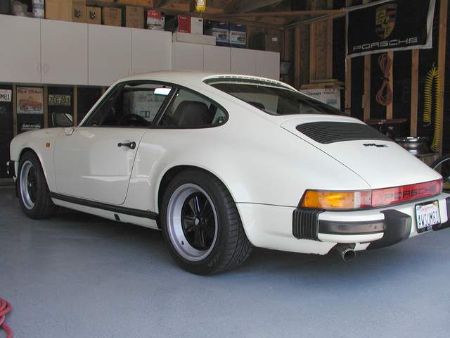

Rustoleum epoxy from Home Depot. Holding up fine so far at 15 months.

It is somewhat glossy with the flakes tossed onto it. I'm sure it would shine more if it were left plain. I ran the roller and my wife followed me tossing the flakes. Flakes/chips/spreckles aren't mandatory.
It cleans up very nicely. I've used laquer thinner on it for tough stuff without any fading or wear. The only problem might be that it looks so nice when it is clean, that if you're an anal fanatic, you might be mopping/polishing your garage floor once a week. Myself, I can stand the sight of dust and a few spots here and there.
On the moisture thing. There is a VHS tape that came with the kit from Homo Despot. They say you should lay a sheet of plastic on the garage floor and completely seal around the edges with duct tape. Let it stay there for 48 hours. If any moisture becomes trapped under the plastic, then your floor isn't yet a candidate for an epoxy seal.
