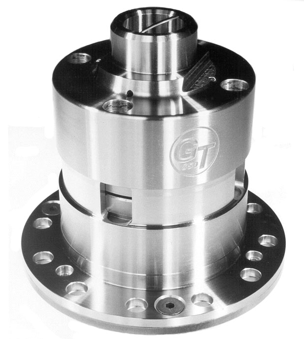

Anyhow, yes .... Porsche parts have been going through the roof. At $2,500 for a Porsche cast unit, our Chromoly fully adjustable LSD sounds like a bargain at $2,150. Only problem is that we're out of stock for the next 2-3 weeks.
The 5-spd transmission requires that the diff have the 3 speedo ring holes. Many of the 993 & later LSDs don't have these. Ours does, because it's meant to be a universal ('87 & later) LSD.
I've never tried to post a photo before. Let's see how it goes ---
Paul
http://www.thesamba.com/vw/forum/album_page.php?pic_id=232531

A little help for our buddy Paul.
All you do is click on the IMG button from your reply field (above where you type) and then paste the address in there. Or you can use the "Click here to Upload a Photo" link beneath your reply field, then it'll permanently be stored on Pelican's web board.
Man, that's a cool looking differential!

Thanks for the help, Kevin. (I thought that's what I did, but it didn't seem to work. I'll try again sometime.)
Yes, I've been pleased with the latest of these, as they now come with highly polished (isotropic normalized) internals.
