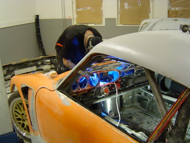

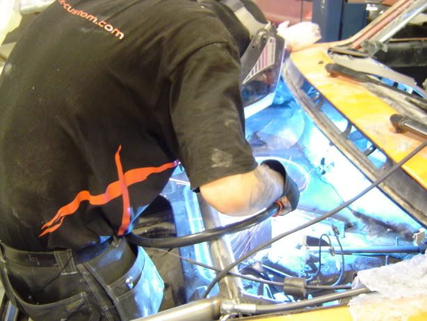

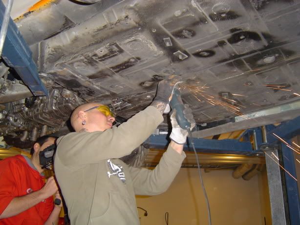

Oil tank is to be fitted up front, so smuggler box was widened somewhat:
Oil tank is quite hot, so reinforced bucket is welded around it to shield coupé from heat and protect the occupants in case of rupture:
Transmission tunnel is cut up so we can weld in new tubes to draw fuel/oil/linkage/brake lines trough:
