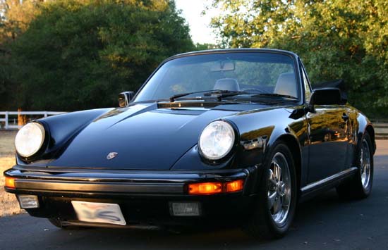

rds356, what did you have to do to get those 18's to fit in your wheelwells? I'd love to do that myself but am concerned about rubbing issues.

as far as the 18's go you must roll the front fender lip's to start.
The wheels must be made for the early cars offsets. Contact RH- Alurad or GMP Performance. They make the 3.6 replica three peice wheel for early cars. Very high quality(made in Germany of course).
The rears are 18x10 with 265 rubber. Needed a special spacer-but that's all to fit just right. No need to roll the rear fenders.
The rear's do come very close to the oil lines and spring plate bolts. At the track the forces generated and tire flex may cause some rubbing at those point's

rds356, what's the low down on the turbo set-up?

Low down as follows: 3.0 to 3.2 motronic conversion including 3.2 P&C'S. Euro 930 exhaust, Protosport J-pipe, Protosprt adjustable fuel pressure unit, HKS wastegate with .5 bar spring, Bell custom intercooler, custom billet aluminum intercooler pipe with intergrated adjustable boost controller and blow off valve &, K-27 7200 turbo.
Muffler is a custom GHL stainless unit.
Some lag and a little lethargic off boost but once the boost comes on you better be pointed in the right direction.
It's basically a Protosport stage 1 with some upgrades.
