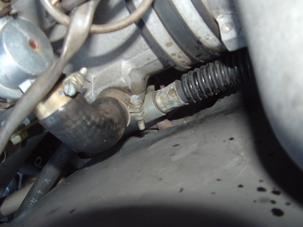

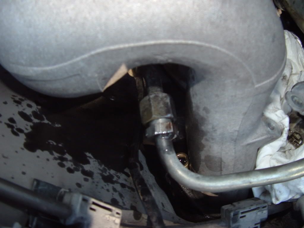

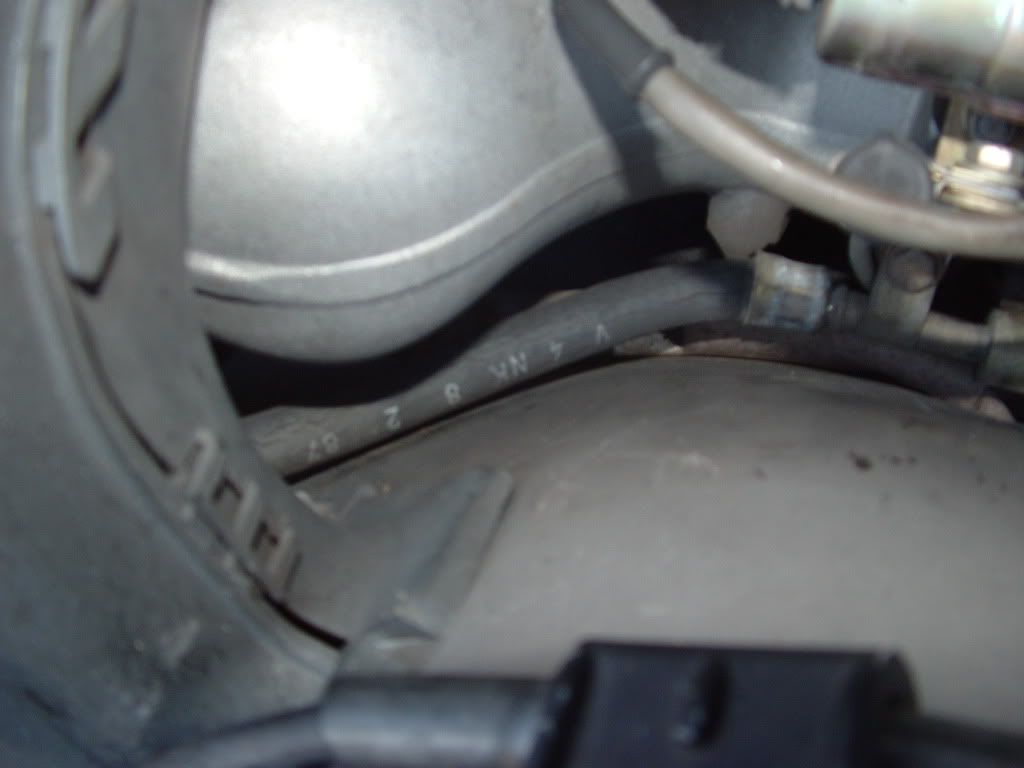

I took a couple pictures of the fuel lines connecting the fuel rails. i think it needs to be replaced
the rubber line on the driver's side looks to be a little brittle.
I could not get the bolts holding the hard lines on the passenger side loose, but i managed to get the injectors out any way
I sprayed them with liquid wrench, so hopefully on thursday they will be loose. you can see the over spray from the liquid wrench in the 1st and 2nd pictures.
