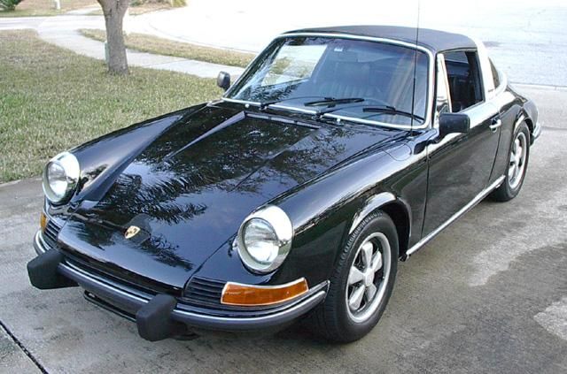

Thanks for the warm replies, per the "rules" here's a pic of the 73:
From the sounds of it, the toss up is between 10w30 and 20w50. I would think thicker the better, just for leak sake. Usually I let the car run for about 4-5 minutes to warm up before I speed off anyway. I think, for economy's sake, I'm gonna go with mineral.

Nice, Nice car!! I use Kendall 20W-50 as well, for no particular reason. I drive my car right from the start but don't push it 'til it warms up a bit.

Nice car.

Sweet ride, but Holy Mother of Rubber Bumpers Batman!

Yeah, the bumpers are pretty hideous(my knees unerringly seem to hit them everytime I'm in the garage), I'd like to get the earlier bumpers, but one thing at a time I guess. I used the car as a daily driver for about 2 years, and mothballed it when I got my Titan. The garage had always done the changes, but I'm going to be taking that duty over now that it costs me $70 to fill the stupid truck.
