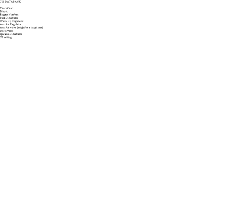

Jim, I was joking put I wonder if there is away to post a form as an image we could save it to our desktops and then email it back to you.
Ok this is a test:
Peace, Ron
www.ronorlando.net
78SC Targa 3.2 SS, 964 cams, CIS, SSI's,Dansk
Own a gun and you can rob a bank , own a bank and you can rob the world.
Old 05-05-2006, 08:13 AM
Location: New Jersey
Posts: 1,861
Well, that didn't work. How about you just list the info that you want to collect, something like this:
CIS DATABANK
Year of car:
Model:
Engine Number:
Fuel Distributor
Warm Up Regulator:
Aux Air Regulator
Aux Air valve {might be a tough one}
Decel valve
Ignition Distributor
CP setting
we could copy and paste the list and the info in a reply or in an email.
