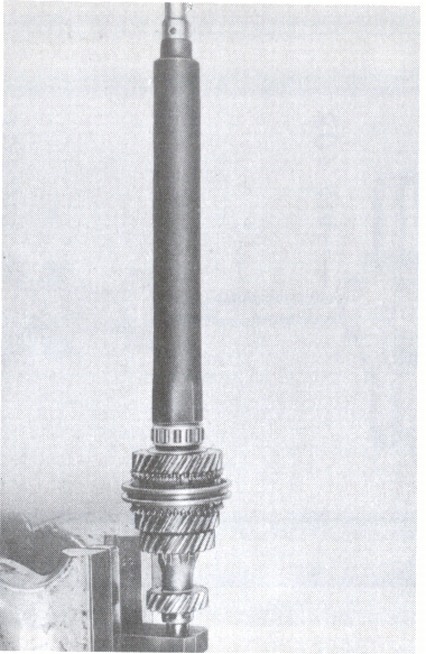

No, this is where you have the input shaft stack
out of the intermediate plate and need to loosen or tighten
the 32 mm nut using P252 or equivalent. The P256 or
equivalent is fixed in a vice so the input shaft assembly is
vertical. This allows you to use both hands on the wrench
and P252 to not put any bending moment on the input shaft.
The Factory Workshop Manual (FWM) shows this operation
with the shaft horizontal. I believe this contributes to the
failure of the input shaft at 1st gear.
© Dr. Ing. h.c. F. Porsche A.G.

The reason for the P256 – P252 arrangement is so you
can torque the 32 mm nut on reassembly.
Here the torque wrench is blue and I would pull with my
right hand (red arrow) while supporting (green arrow)
the tools with my left hand. This is a case where a "T"
cross-handle torque wrench would be ideal.
In practice there is a slight "wobble" play between the
1st gear splines on the input shaft and the internal
splines of P256. If you maintain that wobble while you
torque the nut, you are assured that you aren't bending
the input shaft at the 1st gear end.
You can use the P37/clutch disc method for unscrewing
using a 32 mm box wrench.
The only way I can think to use the P37/clutch disc method
for reassembly torque is to make a 32 mm box wrench
similar to this:

Okay, I'm told that the 914 engine and transmission have been dropped out of the car and my welding friend produced the below work piece (see image). As soon as I finish an on-going air conditioning project we will begin to work on the 901 transmission. I'm now seeking input on what diameter to bore out the original socket drive square to. I recall that the largest diameter on an input shaft before reaching the nut threads is the bell housing seal land. The comparable bore in the similar tool for the 915 transmission is .980" and lacking any other information I will have this one bored to the same diameter. Thanks.
Old 05-24-2006, 06:41 PM
Grady Clay's Avatar
Location: Arapahoe County, Colorado, USA
Posts: 9,032
Jim,
Yes the seal land is the largest diameter. It measures 22.00 mm. The clutch splines measure 20 mm.
Best,
Grady

Great and thanks! Now its off to another friend who is a fair machinist and pretty good experimental physicist too.
