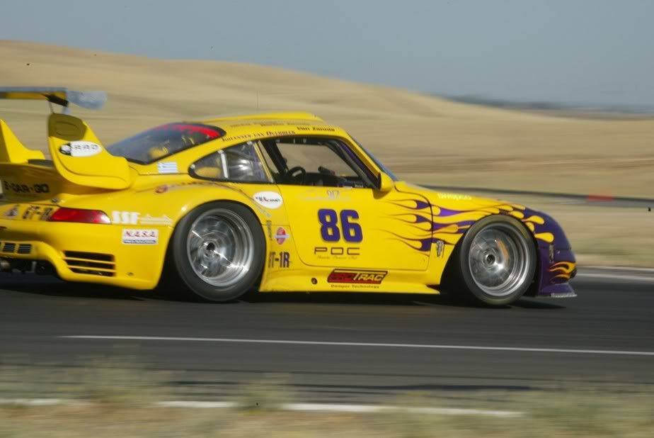

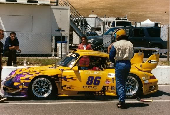

I agree with everyone else that if you want to get more power you need EFI. My engine sounds like it is very similiar to Bruce's . It was built by Rob King at SCARGO Racing and the M48 was set up by Rich Walton and Jerry Woods . On Woods' dyno the motor made over 600hp and 550 ft lbs of torque at 1 bar through mufflers with tiny turbos....ironically we never ran it without mufflers but wanted them for Laguna Seca days when we had to make sound. This motor , I think , has a track record at Road America in GT1 of 2:16 ... even geared way to tall for the track pulling a 190 mph top gear in a 4 speed. So it makes some great power and is dependable..never a DNF
A bunch of old race cars

Bruce ,
The wheels are from Jim Fikse and I am running 14x18 in the rear with 14 1/2 Goodyears and 12X18 in front with 12 1/2 inch GY Slicks . But when we built my friends GT1R car we tested tire and wheel combinations and actally a narrower tire works better and he went to the 13" yoks in the rear. My turbos were built by Greg at Tial Industries
http://img.photobucket.com/albums/v600/ChevyThunder/GT1%20R/442D1715.jpg
