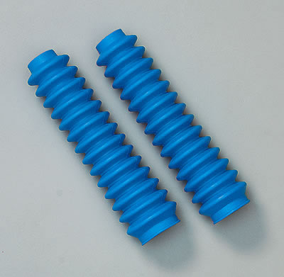

The water shield is the can that goes on top of the strut.
Maybe I can find a rubber bellows to seal it up, keep crap off the strut shaft?

^^^ Oh, the dust cover. Yeah, I would definitely want to put something there in its place.

This was easy to find, and matches the bilsteins....

jhelgesen,
Where did you get those? Txs

Summit racing - search under shock boots, $6 a pair.
