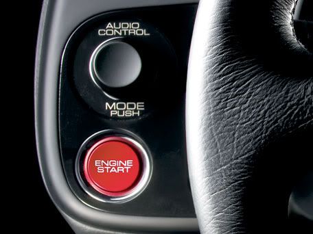

That idea is so rice!
* Image taken from S2000 site.
j/k Sounds like a decent idea. Extra points if you can make the installation look OEM, too.

I didn't want to use a start button, but I couldn't find a replacement switch for my car. So less than 1/2 hour later I was on the road again. I hid the switch under the dash so it isn't visible. Is that still rice? :-)
