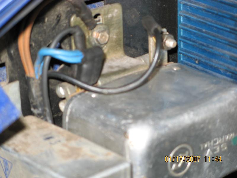

The "extra" black wire sounds like an add-on by some prior owner, can you post a photo? Often the blue wire turns black with age, though.

Where, exactly, does the extra wire go? Remote diagnosis impossible if a PO has changed from the factory setup.

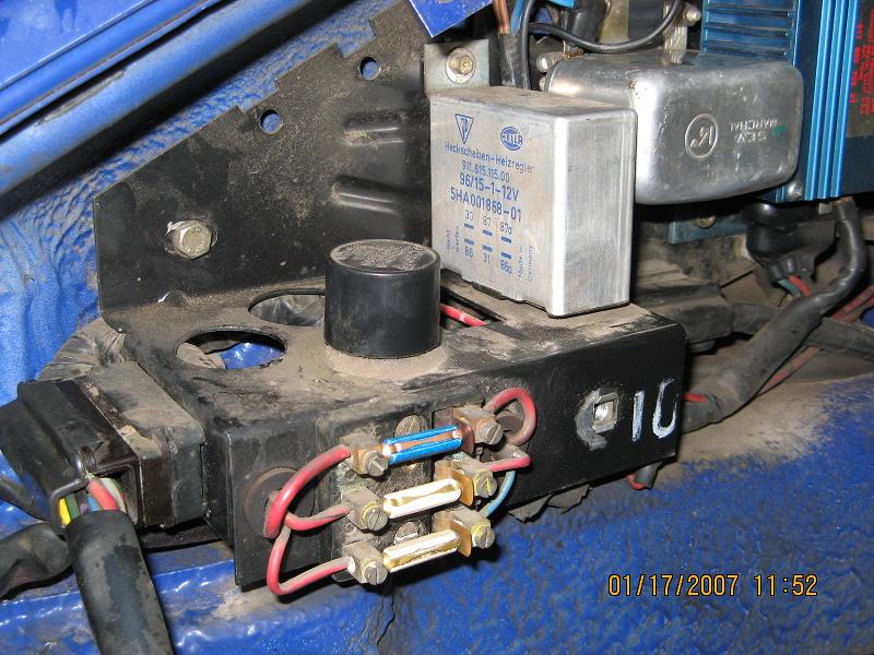

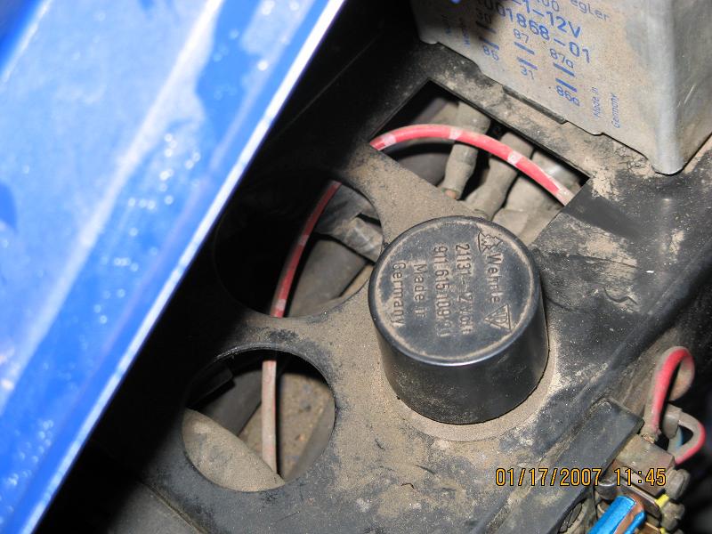

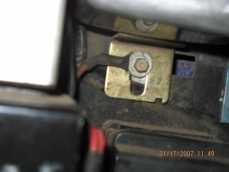

OK, I have data on two things this morning (brr, I need a bigger garage ... at least it's not raining any more).
First, the mystery wire. You want pictures? We got pictures.
First, a general overview of the area:
Now, the regulator's upper connections (sorry about the focus):
Now, the regulator's lower connection:
And a view into the chassis:
It appears that the extra black wire that is connected to the D+ and the extra brown that is connected to the bottom mounting bolt go into the chassis, to the insulated faston connectors visible under the rd/wh wire, and continue into the harness for the relay socket, along with a rd/wh and rd/bk wire. My best guess is that this is the rear defogger relay, and that the well-known 1973.5 911T schematic is a bit out of date as to where terminal 86 actually gets B+ from.
Not too interesting, in retrospect.

I have connectivity from the battery's positive cable to the blue tab at the regulator. I didn't measure resistance, just listened for the beep.
I pulled the regulator. I'll take it to a shop to test. I pulled off the top and inspected a bit - the points have some fuzz, but I've seen worse. They certainly aren't stuck together, and they have low resistance.
For grins, I tried hooking up a power supply to D+ and ground. I have a small variable supply that's limited to 0.5A, and it clamped before I got to 12V. I could see the arm deflect, but not enough to move the points. I then tried a fixed 13.8v supply which does about 5A, and it deflected further, but again not enough. I don't have anything that puts out higher voltage right now, but it appears that I was getting close to causing a switch.
This is ... puzzling to me. Is the rest position to provide a connection between D+ and DF?
Anyway, I'm hopeful that it's the regulator, but I'm betting that it isn't, and I'll have to pull the alternator to look for a loose connection or worse.

Chris,
That round black relay isn't for the rear window defogger ... you have a two-stage defogger relay in the aluminum rectangular box by Hella, as depicted below. I believe the 'mystery' brown and black wires are for the CIS Warm-up Regulator relay as shown below in the CIS Addition schematic from the Pelican Electrical Diagrams page.

Thanks Warren! Yes, that makes sense and matches what I see. Not shown on the Haynes schematic which claims to be for the 73.5 CIS 911T ... oh, there it is, on another page!
So where is the warmup regulator and what does it do? I guess that's really a different thread. :-)

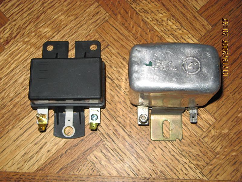

Installing the Transpo ID4010 was a small challenge. The mounting and terminals are close, but not quite.
Here's a photo that compares the two regulators:
For starters, the terminal connectors aren't the same. That wasn't hard to fix. But the CIS addon harness for the warmup regulator relay is quite short, and uses the case of the regulator as a ground path. That doesn't work on a plastic case!
The overall 'vertical' dimensions are larger; the terminals stick up higher than the original, and the upper mounting hole is at the very upper end of the SEV's upper slot.

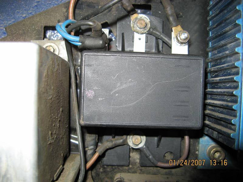

The main regulator harness comes up under the left side of the regulator (see pic earlier in the thread). The ID4010 has a full-width bottom mounting leg, so I cut some of that away for clearance. I made a ground jjumper to go around the other side (and had to carve a little clearance there, too).
Here's the final install:
Seems OK so far. I added some plastic edge strip to keep the black CIS wire from rubbing on the chassis - I don't want to wear through a B+ lead (you can't really discern it in the photo, since it's the same color as the dirt next to it).
I'm a bit concerned about the added stack height on the two mount points, especially the top one; the plastic legs are thicker than the original steel, and the top one has the regulator's ground strap *and* the extra ground jumper.
It's worth noting that the set point on this Transpo is 15V; that seems like it might be high, but I guess they're counting on significant voltage drop between the alternator and the battery. The ID4009 has a 14.3V set point - but that's not the part that 'everyone' sells for this application.

Wanted to link this to another alternator thread
Alt light doesn't work
which implies that anyone doing this change (from mechanical to solid state regulator) might want to add a resistor to the charge indicator lamp socket as described in the Factory Technical Bulletin listed there.
I did so and am happier with how quickly the alternator/charge light goes out at start ...
