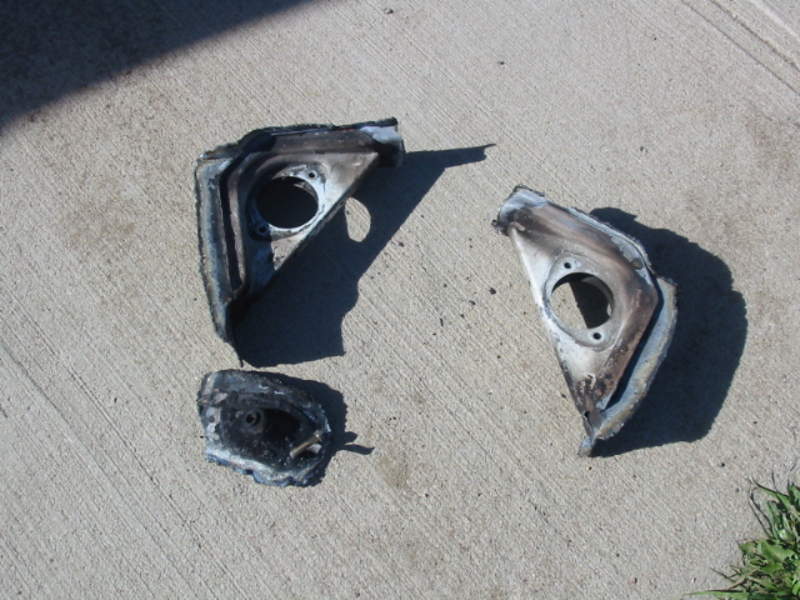

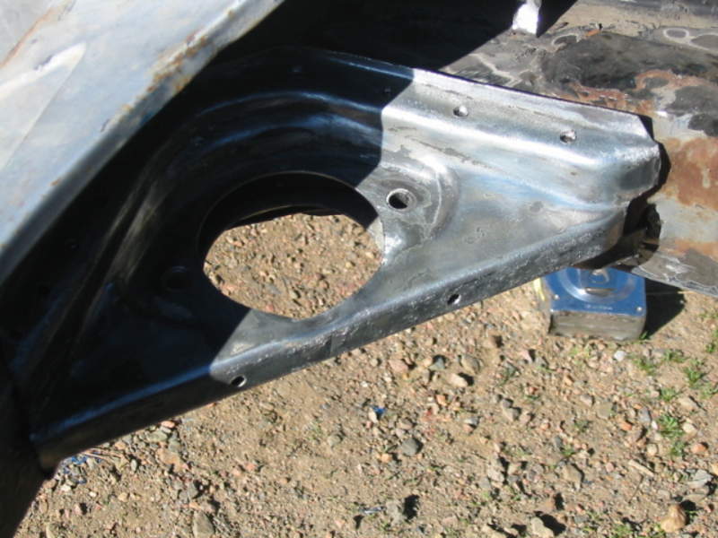

I sourced some 911 rear engine mounts locally which had been cut from an unfortunate race car...torched out actually
I drilled out the spot welds and primed them with weld through primer.

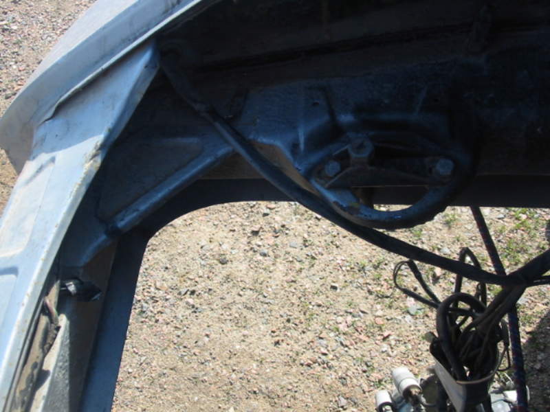

I then needed to tackle the removal of the 912 mount and corner gussets
Once these were removed
And the area cleaned up and primed... the 911 mounts were fited..
Here is the completed result

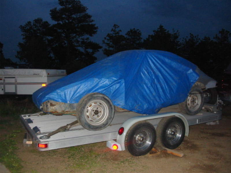

Day three...dragged the car down to the sandblaster at 6:00 am
And picked it up at noon. Very reasonable price...and they said I could keep the media that is stored inside the car.
Surprises...
1) some body work on the left side quarter panel...will need to be removed and taken down to bare metal before the LWB flares get added
2) rear shelf more "perforated" than previously thought...just will require a larger patch
3) rockers are damaged, but can be repaired vs replaced...I had anticipated replacing both sides.
4) jack points solid on both sides
5) fender wings in decent shape...right side requires small patch.
6) front bonnet in decent shape
7) rear seat buckets more perforated than estimated...both will need to be replaced
8) rust holes in left rear quarter below window will require patching
9) rear window lower corners are solid
10) doors are in great shape
11) pedal cluster area on pan was only oxcidized...not rusted
I threw a bunch of extra small parts at the blaster...pedals cluster, suspension pan cover, engine mounts and pulley housing, alternator strap, engine tin etc

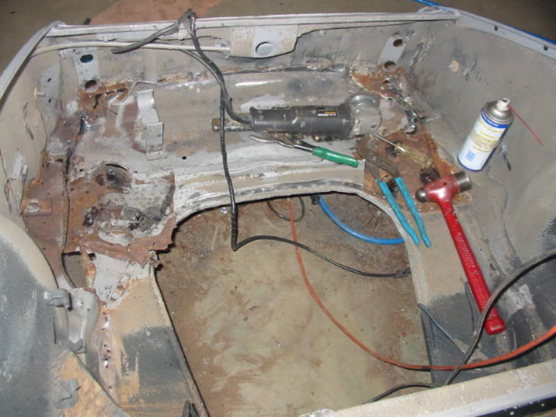

Ok...I can now dive in to the spot welds on the front of the car. The front drip sill was not looking great, but I have ordered a replacement piece so it was first to go
All cleaned up and ready for zinc and the new piece to be welded in place.
I hadn't planned on diving into the removal of the front suspension pan, but as it too was en route, and I couldn't weld anything else today....lets drill out 300 spot welds. I have another couple of hours of prep, but the pan is 85% drilled out and ready to be cleaned up and prepped for replacement. I will have some peripheral steel to replace next to the pan, but not too much. To my surprise, this area had a botched repair done at some earlier time that I uncovered while drilling out the welds on the lower drivers side.... what a hack job. The good news is that the inner fenders are in good shape. I will need to refabricate the battery ledge after I get the suspension pan welded in place
I realize the last picture looks pretty gnarly with missing metal, rust and power tools....hey, it's a project.
