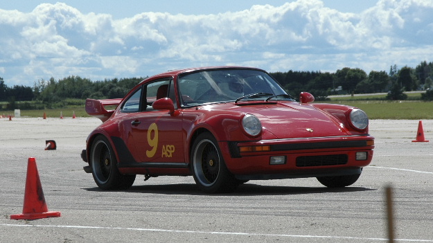

It's been a few months since posting this question about my de-cambering rear ...but I thought I should share with the board that the Elephant Racing monoballs did the trick.
It took me a while to source all the bolt hardware, get it installed, set the corner weights, and align it all up again ...but it all paid off with a really good showing at the Slalom at Slemon in PEI this past weekend besting a gaggle of S2000's, 350Z's, Vette's, M3's, etc...
Why do they even sell the plastic inner bushings? After I disconnected the trailing arm it was quite apparent that the inner banana arm would only move in one dimension causing a major bind in the travel.
Here's a picture of the same type of corner as at the Cdn Nationals but the rear tire is staying put.
Funny side effect since I installed the rear monoballs, front strut monoballs, and the torsion bar polybronze bushings though... my front tire doesn't lift as much as it used to (even with the exact same swaybar settings)
Thanks for all your help guys!
