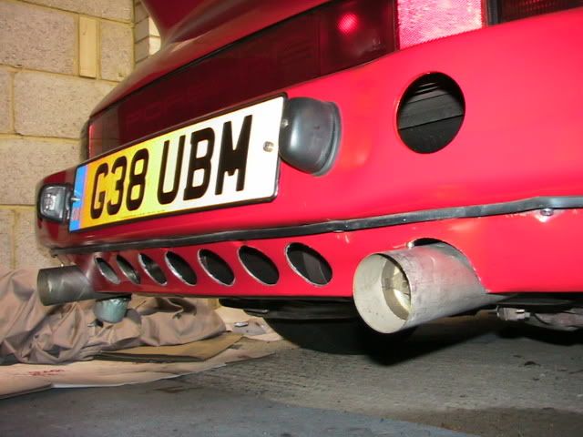

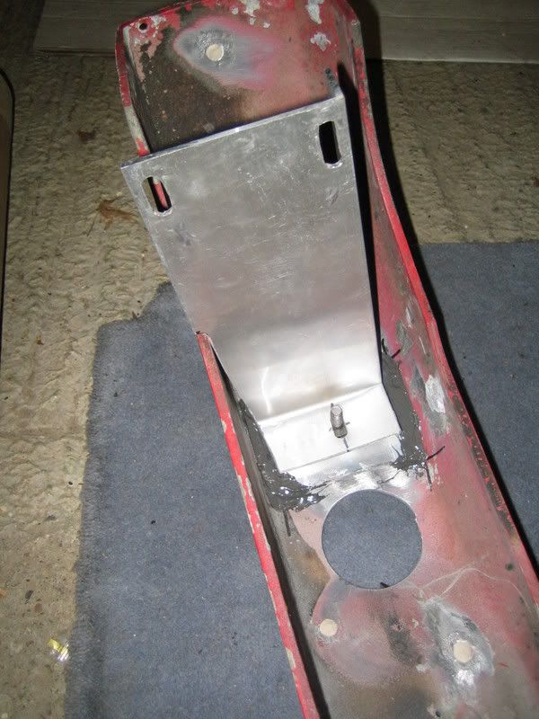

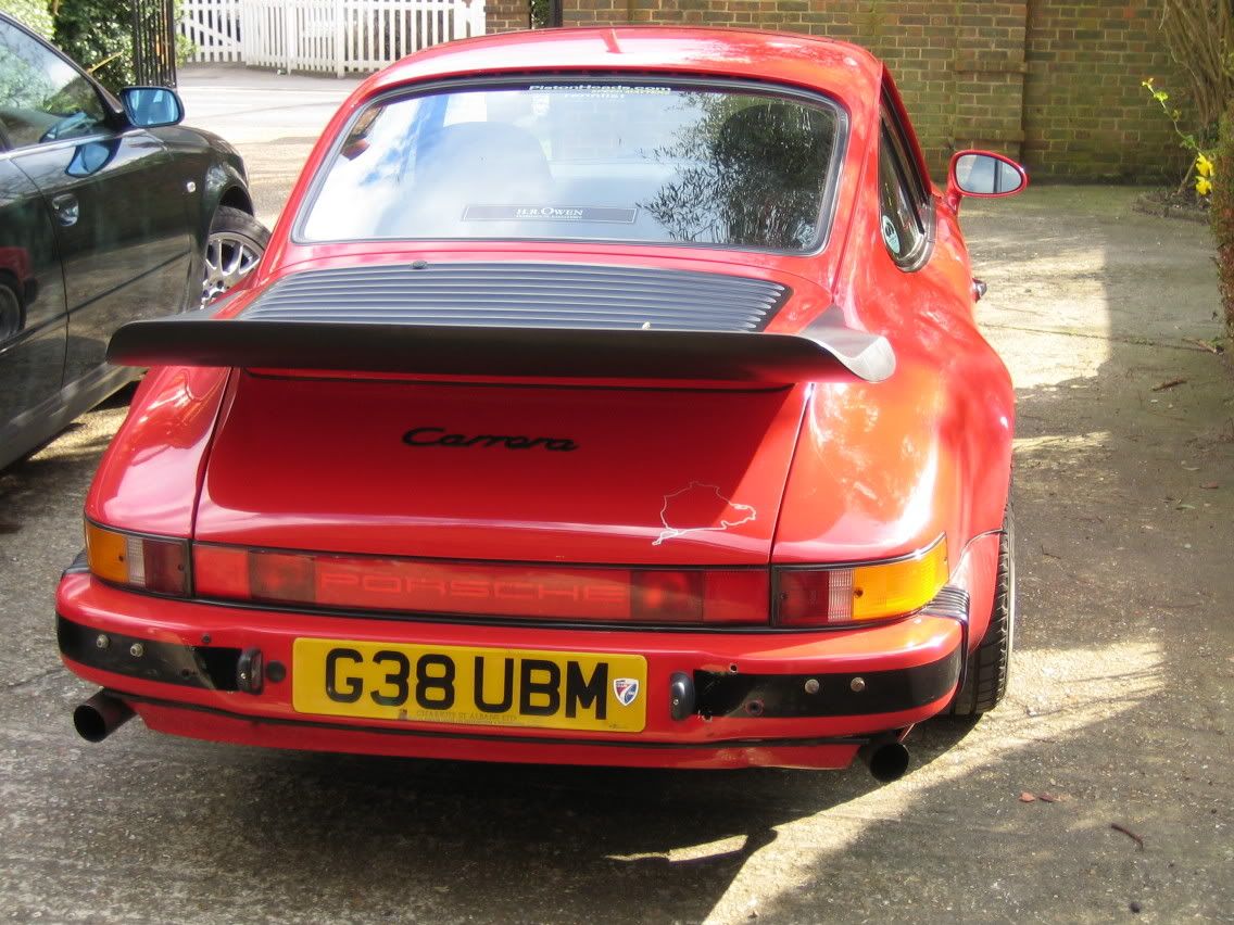

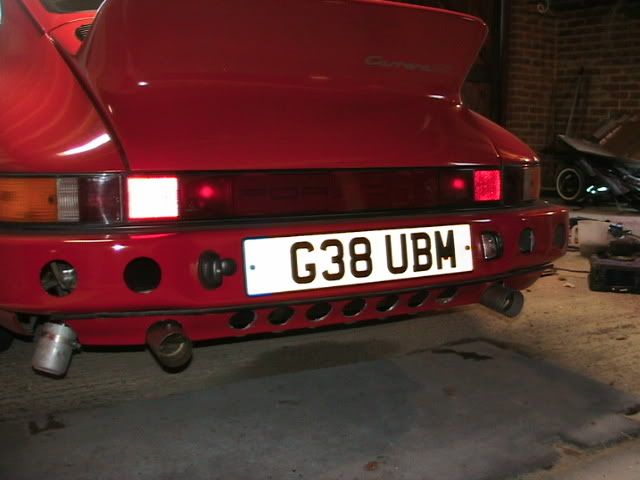

I have pretty much finished my bumper mods, inspired in no small part by this thread and the shining light of 89911 and others. I have run a naked bumper but with holes etc and some black vinyl for maybe 3 years and decided over winter to tidy it up. It started like this -
Holes were cut like this (the bumper is just sitting on the car not mounted) -
JB Weld was used to plug the holes and attach studs to the bumper. Mounts fabricated from Aluminium extrusion, like so -
More or less finished result with valence that had been previously cut for wide spaced 2-out muffler, though now running a 3-out rallye style muffler from M&K -
RB
