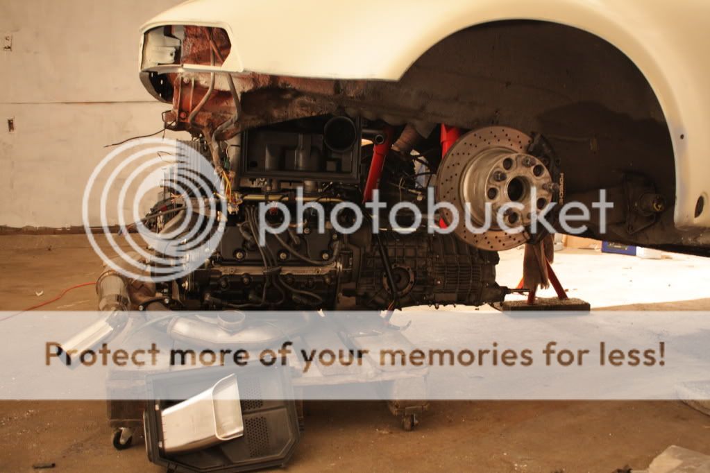

MrHuebler 04-27-2009 12:31 AM
Originally Posted by AirCooledExcellence (Post 3534923)
Any ideas what's supposed to happen with this hose (marked with red dot):
http://www.zen78885.zen.co.uk/ForumP...93Engine14.jpg
i am working on my install, and have the same question, plug it? Hook it to oil tank? Is it needed at all?:D
http://i531.photobucket.com/albums/d...g/IMG_7039.jpg
Thanx.
E, Norway..
AirCooledExcellence 04-27-2009 01:07 AM
Plug it!
MrHuebler 04-27-2009 01:18 AM
Thanx.... Hope i can fire it up within a couple of days now:) Wiring is almost done, fuel lines done, oil lines soon to be hooked up....
AirCooledExcellence 04-27-2009 01:21 AM
Exciting times! Hope it all goes well, good luck :D
