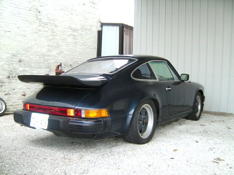

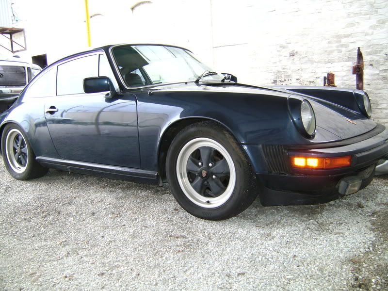

Welcome to the forum and lets see some pictures of that car!

1977 911

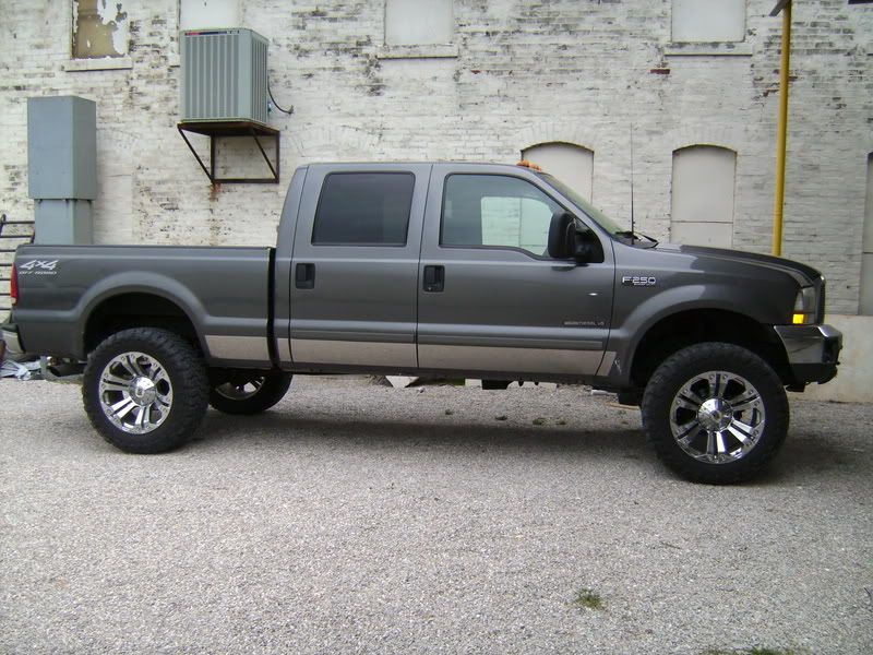

A few of the other toys.
