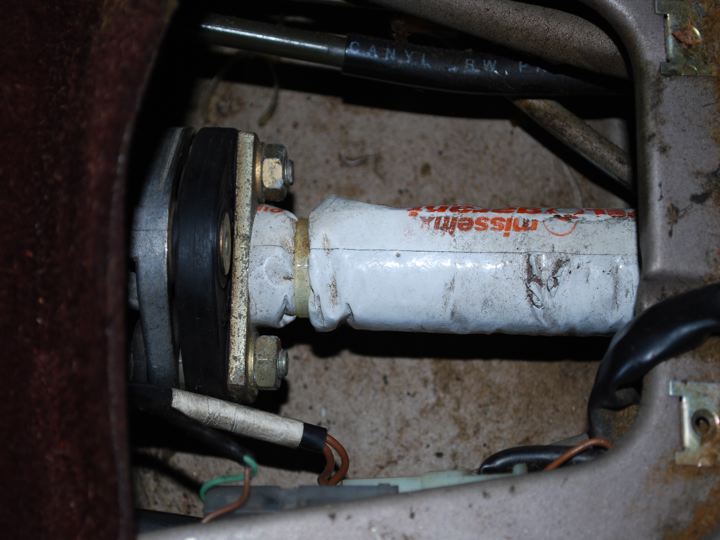

Please help me out.
I'm in the middle of replacing my shifter bushings and can't get the shifter assembly back into the car. The shift rod extends ~1/4 inch too far and won't slip through the bushing. I've read that others have disconnected the shifter rod under the rear cover--but then had trouble reconnecting it.
I'm afraid I'm in a bit over my head--at least with this step--but can see the light at the end of the tunnel on this project.
Here's a shot of what I'm trying to return it to. You'll see a pile of leaves / paper under the shifter--wait until my next post and I'll describe what I found and pulled out of there.
If I disconnect the bolts holding the rod in place, what problems will I face? Is this what I should do? This is what my rear tunnel looks like--G50 transmission:

Hi David,
Yes, getting it back in is a bit tricky. Here's my post when I completed this job:
Completed 1st DIY - G50 ball socket - Thanks PP
Yes, I undid those bolts you are asking about and supported the other end of the rod with a rag to assist sliding it all back together. I found that the trick of supporting the rod with a rag or sling was very helpful.
There are quite a few posts on this if you want to research some further info but that should get you out of trouble.
