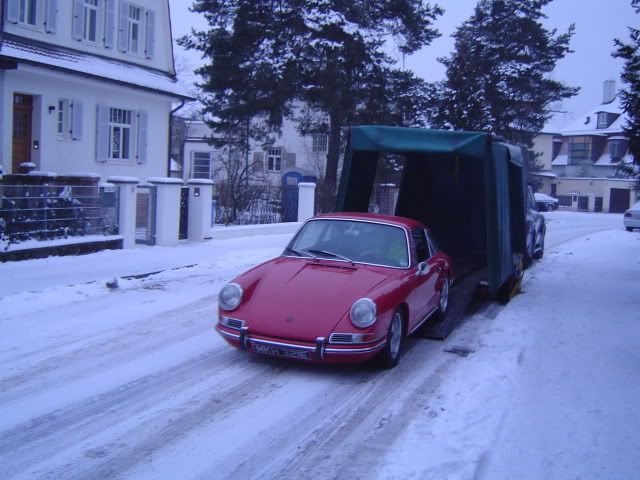

jury 11-27-2009 12:09 PM
Hi Phillip,
1st picture (sorry not a great angle) red car has 14 inch fuchs with a 195/60 tyre
2nd picture (current setup) red car has 15 inch fuchs with a 195/60 tyre and lowered ride height.
http://forums.pelicanparts.com/uploa...1259356043.jpg
http://forums.pelicanparts.com/uploa...1259356060.jpg
HTH
Chris

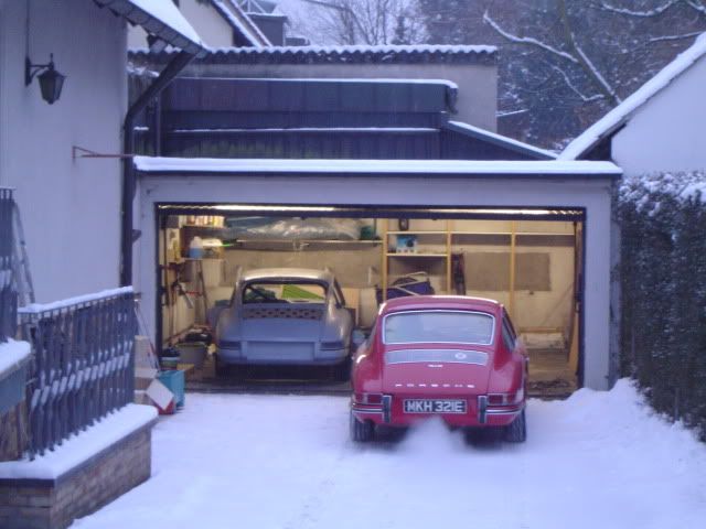

jury 01-19-2010 11:23 AM
So onto the next chapter.....
Cars have arrived in Germany, need to setup the garage (thats 4 now and counting) then I can work towards that classic LeMans completion.....o'yeah the weather has been seasonal!
