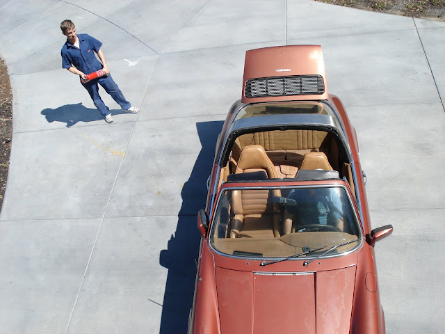

Thanks in advance gents. I really appreciate all the help I've received here thus far. Here's a picture of the subject in question and captures how scared of engine fires (yes, past experience) I was after we fired her up after a 6+ year sleep.
