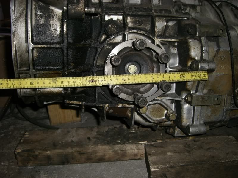

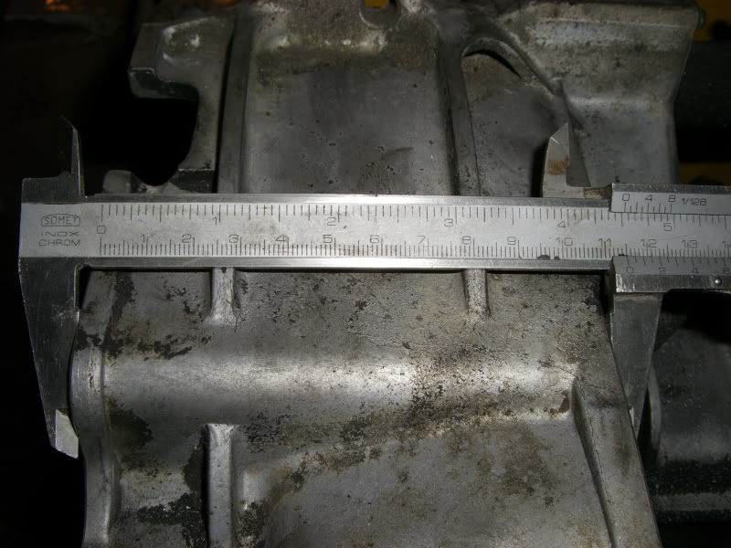

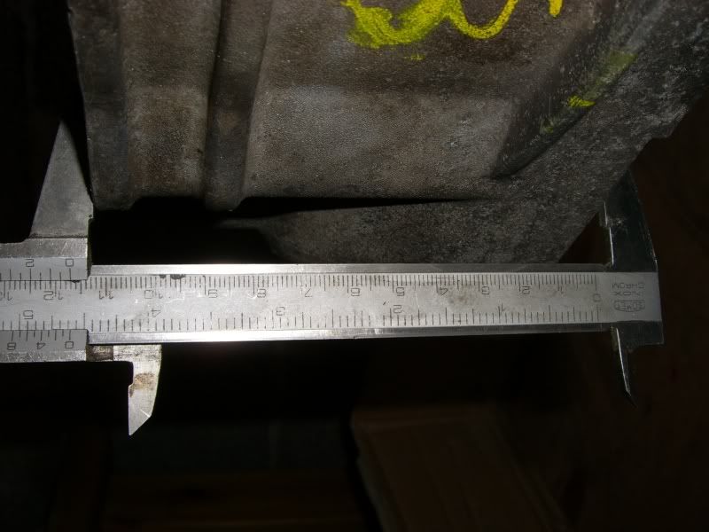

The larger differential g50/52 have makes the diff house approx 23mm longer + 2mm more from the starter surface too the engine/trans surface
picture of g50/52 diff house length
picture of g50/01 diff house length
The measures are not very accurate, but they indicate the difference

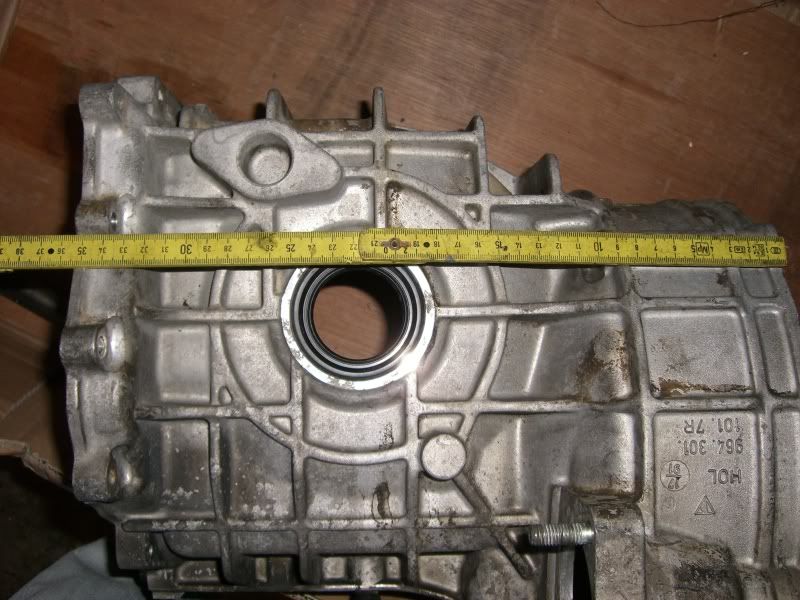

Here you can see the bell house different:
g50/52
g50/01
The numbers in your lates post are similar to what I have, but I need + 2mm to get the right starter distansce. It would really be perfect to machine 28mm. It would make better fit too the To bearing and the guide tube, but than all the reinforced area will disapear... I'm not so sure thats a good idea....??
Dennis: The ruler was just for the picture. I know if I machine 28mm it will only leave a thin lip of the reinforced area (0-1mm). 25mm would be as much as I dare if I need the reinforcment.... Maybe the 6 speed bell house and g50/52 are the same except the reinforcment. It seems like the amout you machined would work for me if it hadn't bin for the reinforment.... What starter do you use?
