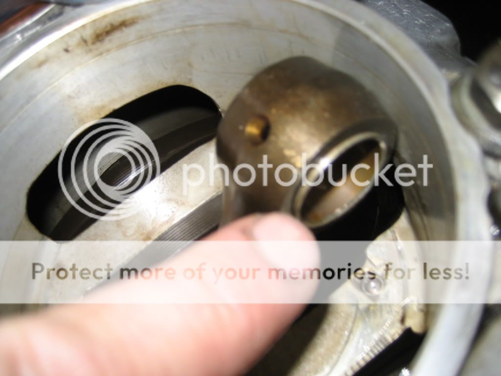

Do I have to split the case?
Do I have to split the case to replace the wristpin bushing (in order to remove the rod)
I nicked it good trying to get the piston pin out.
Thanks,

not nessarily but if youre that far down reseal the case any way.
Rod bushing, put the pin back in fit it because the pin floats so it only has to be free.

At this point you need machine work on the rod, best to split the sucker and do it right. Have them all re-bushed and balanced, it's the only way to be sure.

You can remove the rod without splitting the case. Since the nick is on the edge it's not a big deal. I would just take down the high spots with a rat tail file.
I would make the decision on whether or not to split the case depending on the miles on the bottom end. If it's got a ton of miles then the bottom end will need rebuilding anyway. If it's low miles then why create more work when it's not necessary?

you could clean that up with emory cloth

109k Miles is not enough to warrant splitting the case to replace bottom bearings IMHO.
As for the wrist pin bushings: I f there is no play, or play within specs, I would file the nick a little and leave it.
It's your call.
If the bushing needs to be pushed back into place, use a C-clamp with pieces of ALU or brass for protection. Make sure that the holes for oil delivery line up.

Toss up. You could double those miles easily before rebuilding the bottom end but on the other hand a completely rebuilt motor is worth more than a motor with just the top end rebuilt.
It's quite possible, however, that this motor will last the life of the car without ever rebuilding the bottom end. If it were me I think I would probably just remove the rod, clean the burr and re-attach the rod with new rod bolts. I would inspect the rod bearings however to insure that the bottom end is healthy.

So the rods (if need be) can be removed without splitting the case. Thats good news.
